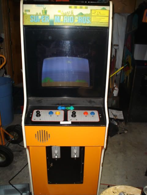

just made a trade for a descent vs super mario bros
guy was asking like 250 for it or trade
my cousin gave me a descent 3.0 ghz dual core pc a few weeks ago ive been using in the shop but i got a laptop so i really did not need the desktop (needed the room also lol)
so i put it in a nice new case i had lying around and threw a good sound card in it and offerd it in trade and he bit
so without further adu here is my 20$ mario brothers lol
over all not to bad the cabs in great shape but its missing the coin mechs and someone hacked a coin up button behind the coin return button
needs a cap kit bad (jail bars and the brightness pot does nothing ) but no burn and it plays perfect
cpo is great and the moulding is descent enough i dont need to replace it

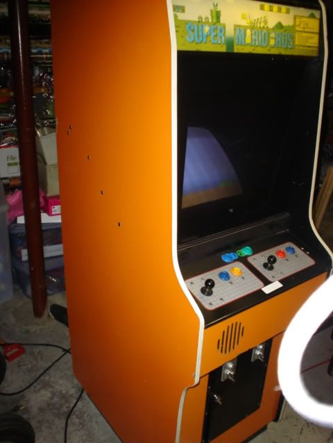

here is my 2 bros side by side

after a little digging into the machine someone has replaced the original marquee light with a standard fixture but its plugged into the 100 v socket in the cab
do i need to fret over this or is the only thing that can hapen due to this is the fixture will fail sooner (ie can this damage the power brick)
It will just go out sooner, but honestly I wouldn't worry about it. How often are these things on anyway? All of my Nintendo's have had that, and I have yet to replace a bulb.

Great score, FYI, if you turn down the flyback brightness a bit the horizontal/simi diagonal lines will disappear. Plus the picture will probably look a bit less washed out and more colorful.
Also, it looks like it has early onset jail bars, a cap kit is most likely in your future.

yea i new it needed a cap kit the brightness pot does nothing (didnt realise it had a brightness on the flyback the flyback is so buried on the ez20 i never even looked)
so hopefully the fly will at least get rid if the white lines as for the slight jail bars i can deal with that for now

indeed it was the fly brightness they had it cranked all the way to hide the super bad jail bar going on i adjusted it so there is no horz white line and there in only minimal jail barz (the brightness on the chassis also works now lol
thanks for the heads up
