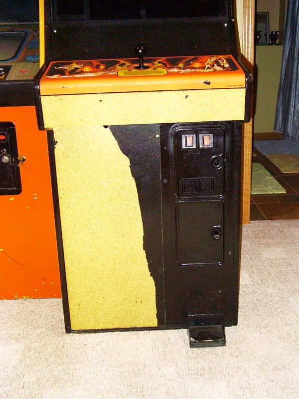

Picked up a cheap Roadblasters machine, and I'm currently repairing all the damage to it with the eventual goal of having Marble Madness installed.
There was a fair amount of water damage on the bottom edges that extended up about five inches on one side. The other side wasn't nearly as bad for some reason.
I stripped the vinyl off the sides and started sanding down the swollen particle board. The corners that were chipped off were rebuilt with Bondo.

I had to reglue the side back to the base. I used the high tech clamping method of putting a heavy, large metal box onto the top. The areas weakened had several coats of Minwax Wood Hardener applied.
In hindsight, I would have done the wood hardener *after* the majority of the sanding was done. For the corners, I coated some old shims with tape and used them as forms for applying Bondo.
Originally, I had planned on painting the sides, but I found a promising vinyl material that I'm going to try out on it instead. The primer made it easier to see pits and dings in the surface.

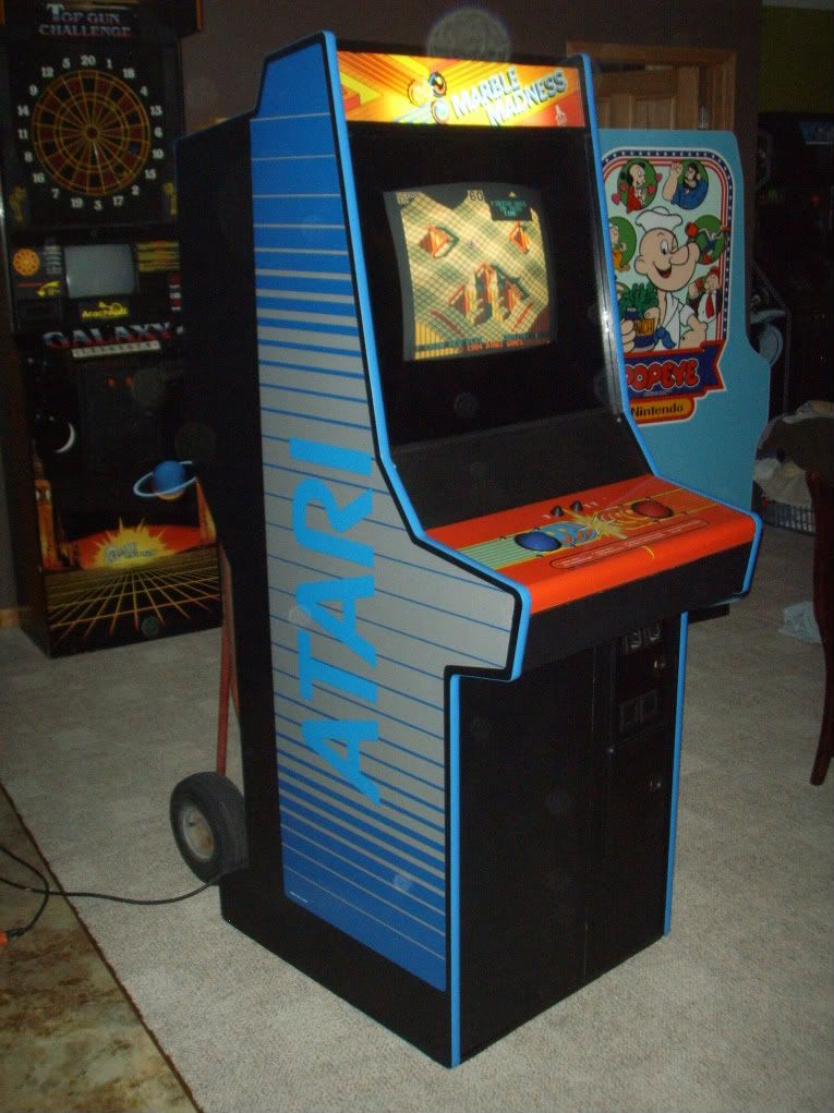

Hey, I've been down this road before. Bought a RB, changed it to IJ, Roadrunner, then MM. Good luck, these cabs clean up real nice:
Thanks! I'm having fun with this rebuild, despite the neverending sanding. I'll have one or the other done in a few weeks.

Atari Sys I cabs originally had Black vinyl on them. I redid the vinyl on mine and it worked perfectly:
I just tore the old vinyl off, patched the holes and gave the particle board a clear coat before applying it.
