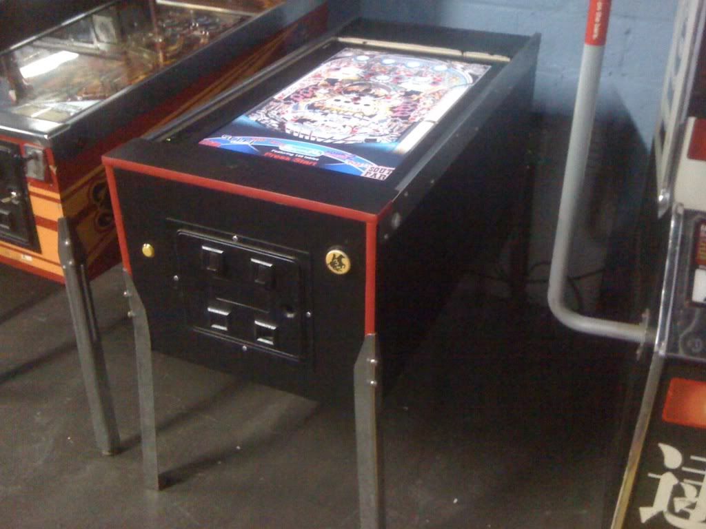

Back then?? Bring over some beer and we'll log some hours on my mame which still runs DOS
That is pretty killer. What is your setup on it? How and can you change your tables seemlessly or do you have to bust out a keyboard/mouse. And is that a 37" LCD or what are u running in there. Any instructions? That is pretty cool I like it!!!
no need for a keyboard or mouse you use the flipper buttons to slect a table
and i wired one of the setup switches inside the coin door to exit the tables back to the game select menu
im still fighting an ishue with my back glass monitor not wanting to display the dmd's corectly but its up n running now
here is a thread i did on the build
http://forums.arcade-museum.com/showthread.php?t=168427
