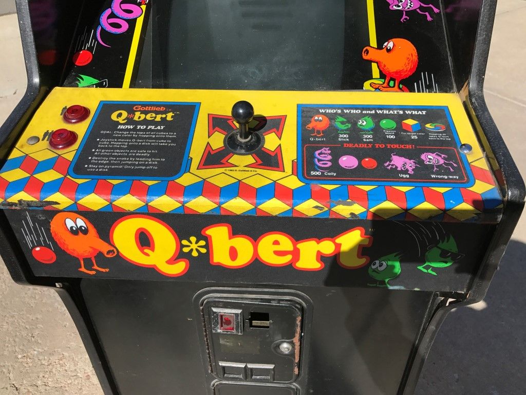

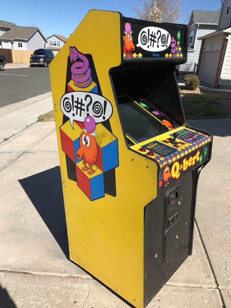

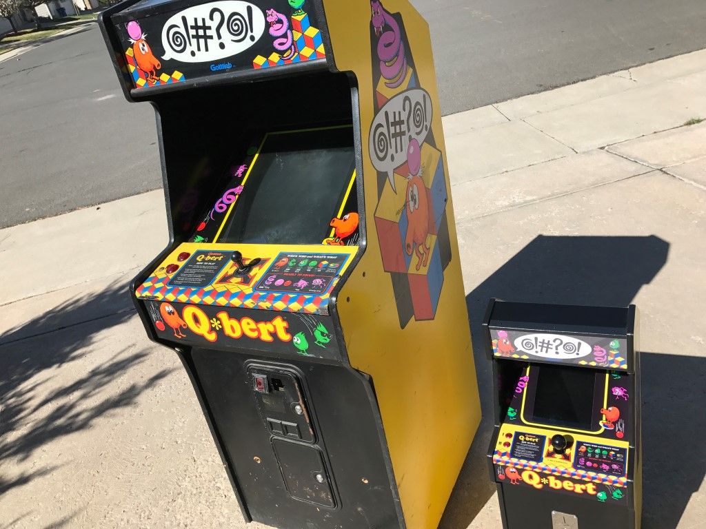

I love Q*bert. So I built my own 1/2 scale replica. But I always wanted the real thing and finally snagged one over the weekend. I feel extremely lucky to have found one, let alone one in such good shape and with a swearing marquee. I've got 5 other machines in queue, so this restore could take a while.
I plan to do the following for this partial restore:
1. Rebuild the power supply. (More on that later)
2. Replace one of the coin mechs
3. Replace the CPO
4. Re-cap the monitor
5. Replace the T-molding
6. Replace door lock and coin lock
7. Patch lockdown bar holes
8. Touch up paint here and there
9. Install the multi-Q*bert game kit

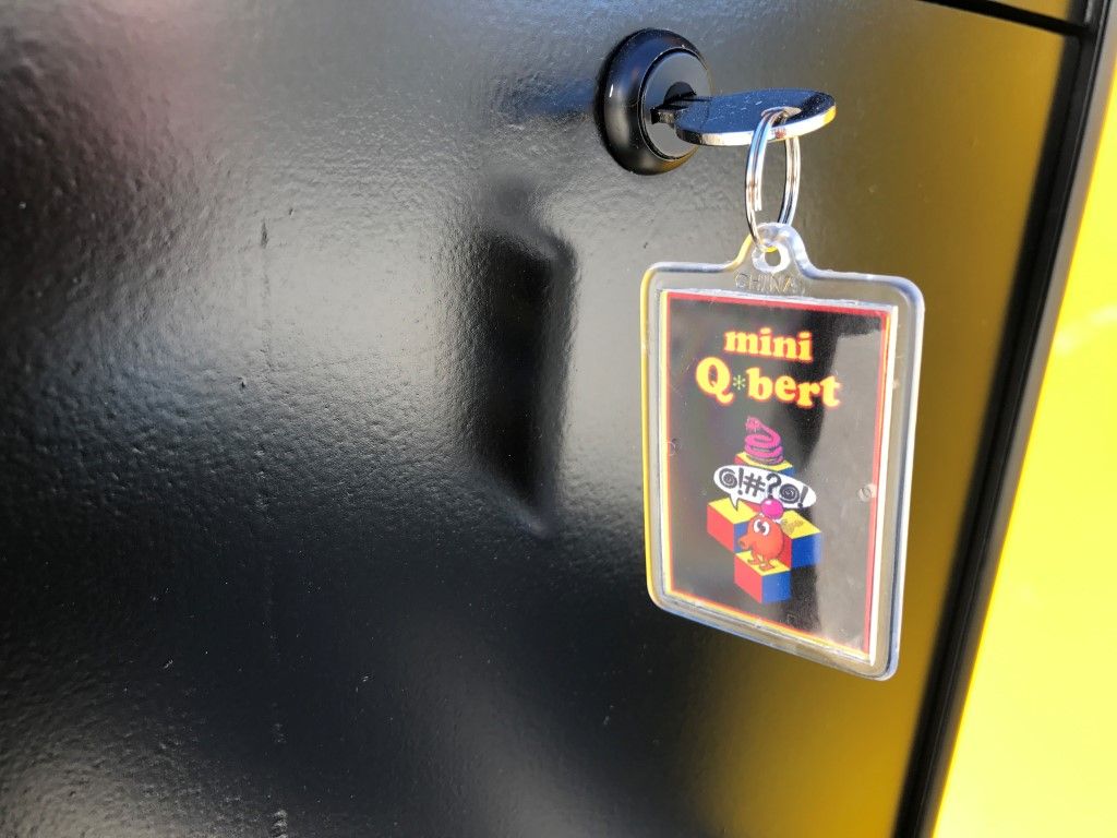

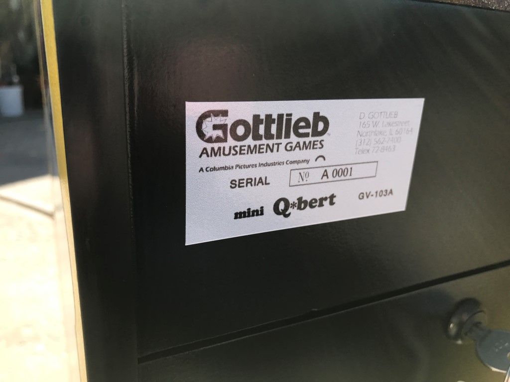

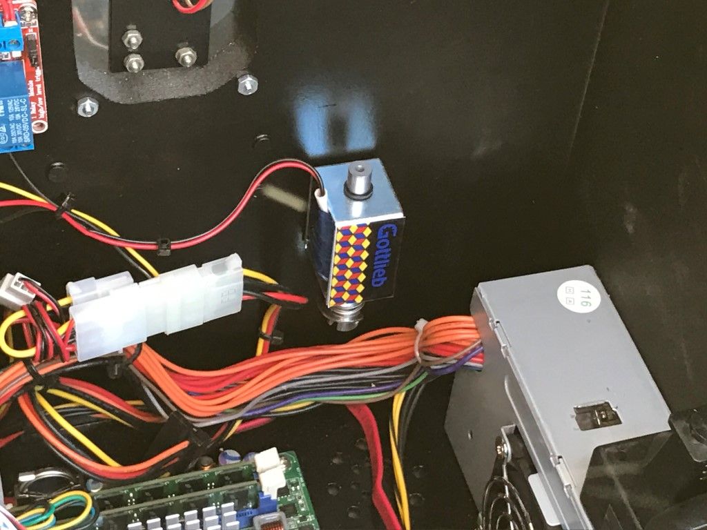

mini Q*bert's keychain and serial tag
Yes, mini Q*bert has a working knocker. :)
Boards are very clean.
I know serial numbers bounced around a lot and didn't always start at zero so does anyone know if this number is early?

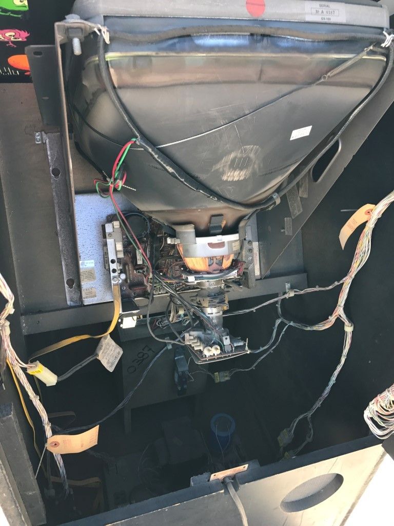

I believe the monitor is original as it shares the same serial number as the cabinet itself.

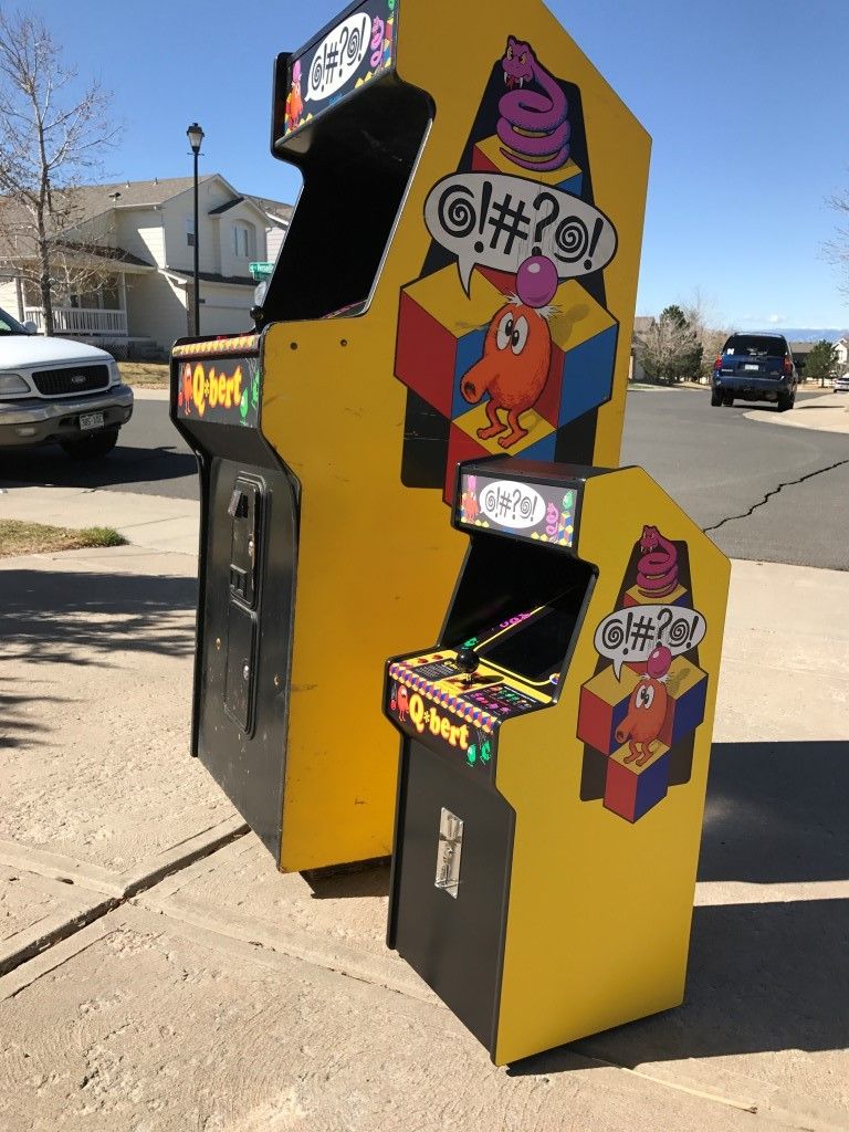

Another shot of the other side. I'm probably going to leave the side-art alone. It's in pretty good shape.
I'll be the first to say congrats. That thing looks like it just needs a good cleaning and call it good. Great looking survivor.
Thanks! Agreed, a good cleaning and a new CPO and it will look really great.

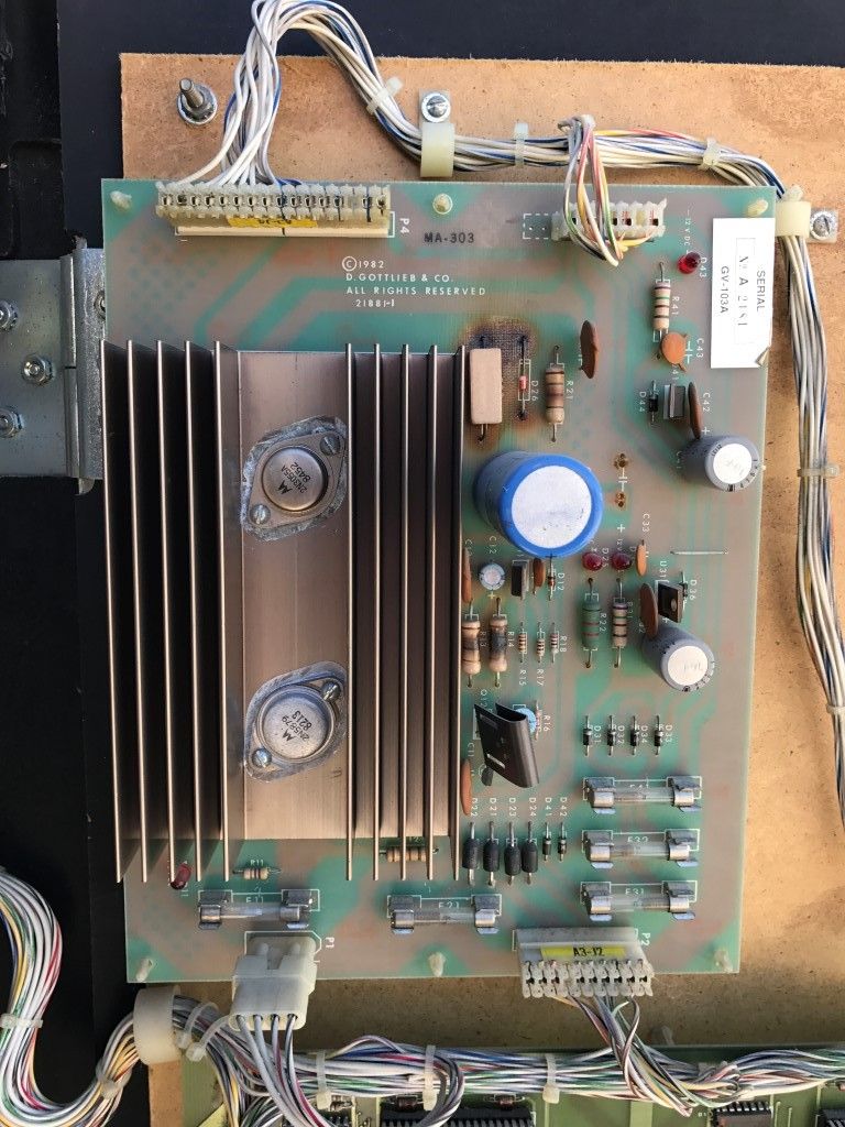

Bad news is that it only works for about 2 minutes before I noticed smoke coming from the back. One of the resistors was red hot and smoking!
This happened before I bought the machine. So needless to say, I got the game for less than expected.
I'll be rebuilding the power supply for sure. I heard Qbert power supplies were made with cheap parts. Think I'm going to use Twisty Wrist's rebuild kit here:

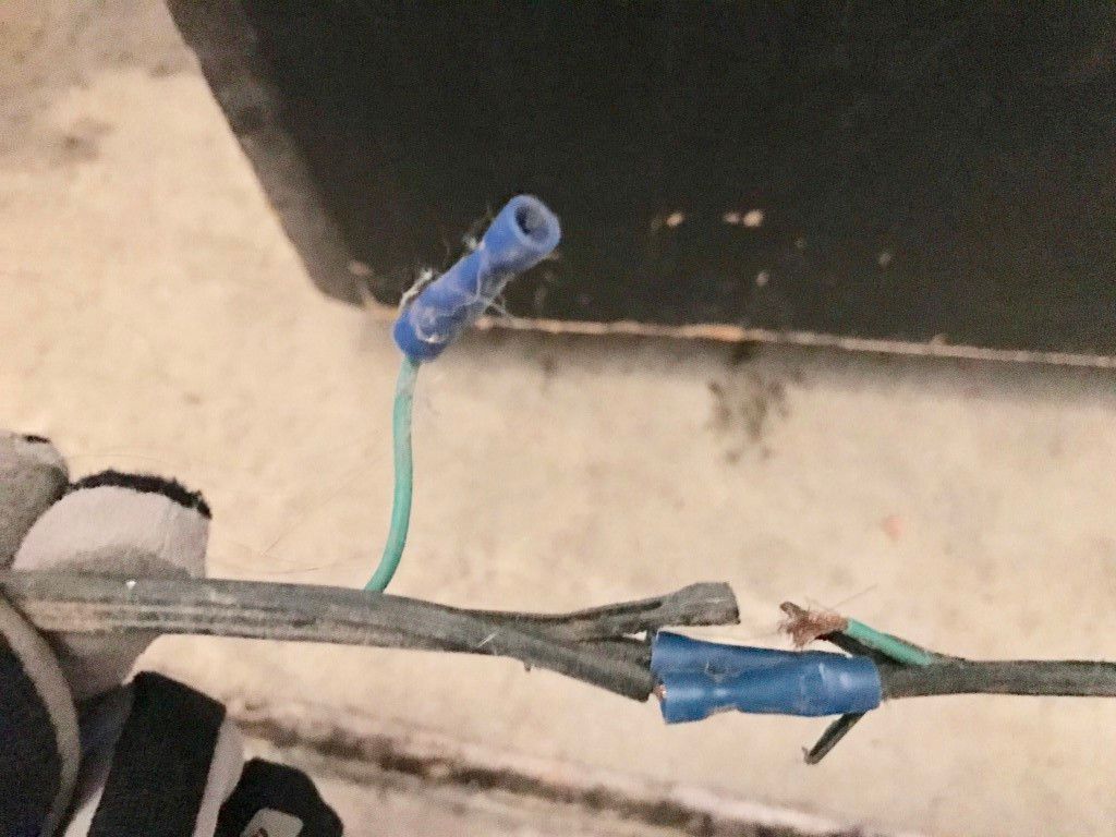

I also noticed that the power cord was frayed. Do you think this had anything to do with it? LOL:

Your missing a cap off of your power supply.
Be carful removing the bottle cap transistors. The transistor spacer is extremely brittle and will crack and fall a part on you if your not careful.

Holy cow! You're right!!! GOOD eye! Thanks for the tip on the bottle cap transistors. I've capped a few monitors before and a Nintendo power supply, but this PS will be a first!

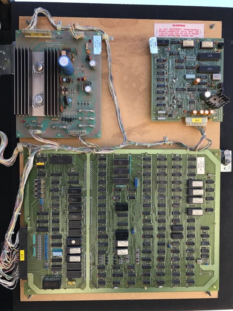

Here is a better shot of the entire PS. And the missing cap you pointed out! (right of the blue cap...hmmm I don't see a cap number next to it)
While you might not see the cap number but you can tell where one use to be.
The zener diode is a smaller value Voltage or Current on your power supply be the looks of it.
Now the amp on the sound board should not be affect that much due to lower voltage or current.
The lower voltage and current will affect the knocker. The Knocker might have been replaced with a lower voltage version.
Why are these points worth mentioning? If you rebuild the power supply you might end up over driving the knocker and cooking it.
