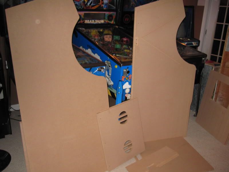

Today I started the making of a new cabinet for my Zoo Keeper.
This restoration/creation will take me a while and I'll try to keep the thread alive as I go. For now, I have all of the pieces of the cabinet cut, but there are still some little things to do to a few of them:

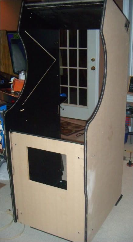

I started to assemble the cabinet without glue just to make sure it al fits. Ignore all the dust on the top piece:

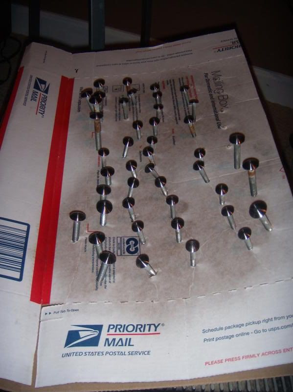

The tons of bolts in this game, all sanded and clearcoated:

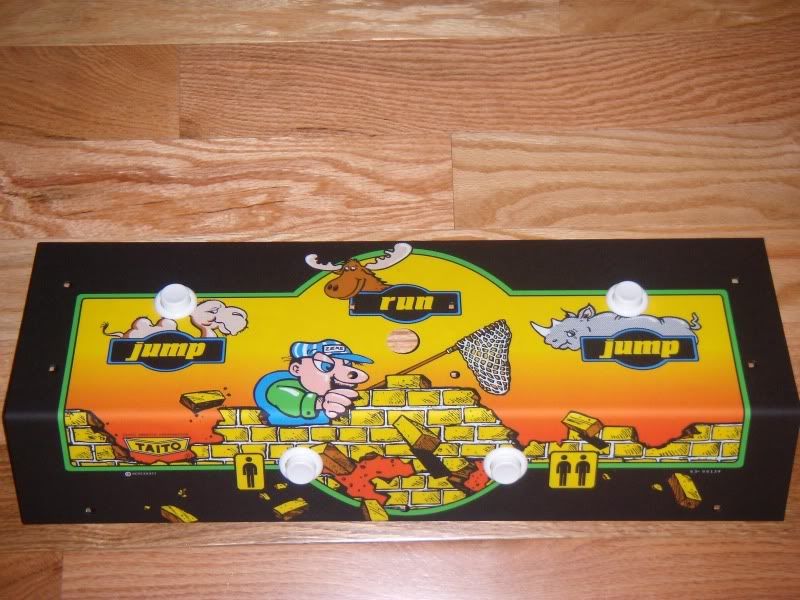

The control panel with one coat of paint on it. The filled holes are actually perfectly smooth, but you can still see them through the first coat with the flash of the camera. I'm going to sand it a little and then put one more coat before putting on the new overlay.
And something original....I love the original coindoor. I might touch it up a little, but not a full repaint. I LOVE the Taito plate in the middle.
Finished the control panel tonight. Not much else to report.
Putting this cabinet together was very frustrating at first. My advice to anyone else attempting one: have a lot of clamps with you. I needed at least about 8 or so to clamp it all together as I built it. I'm hoping to have it completely constructed tomorrow.

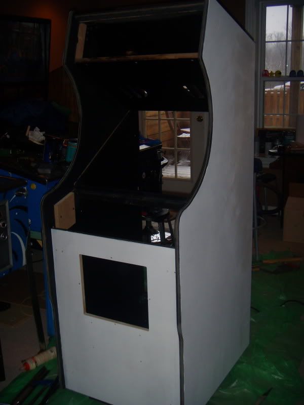

Put the bottom on yesterday. Primed today. I'm just rolling on the primer and orange. I'll sand it perfectly smooth and clean it before applying the art. I'm going to spray the black with just spraypaint. I've sprayed the monitor area of other games with spraypaint before it usually comes out flawless.
Picture of progress with the white primer still drying: (Ignore the mess of a gameroom)
