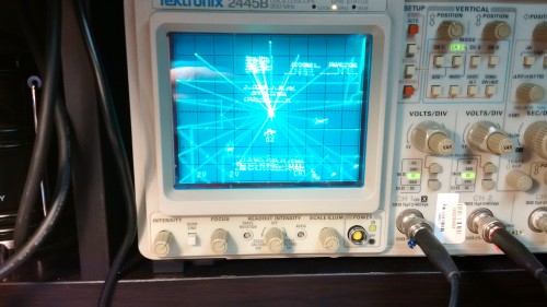

Ok I recently finished my major havoc repro pcb and after I powered up in watchdog, I noticed I had cr8 installed backwards. I pulled and tested cr8(tested good) and replaced with a new 1n270 to be safe, still in watchdog. My 6502b was a cmos variant, and while waiting for one from china(still waiting...) I decided to install a 6502 from my tempest pcb, which brought me out of watchdog. Unfortunately I'm having issues with stray vectors, would this have anything to do with using a 6502 in place of a 6502b? Cr8 seems to be part of the linear scaling circuit and is tied to r70,71,72,73,74,75(which all tested good with a leg pulled from the board)c51 which is 10pf(doesn't register on my multimeter) and the dac-08. I've read through numerous major havoc repair threads and can't seem to pinpoint my issue(s). I did replace the resistor that a member found to be incorrect in the bom(I believe it needed to be 1k). Any help steering me in the right direction would be greatly appreciated. Here's a couple pics.

What "stray vectors" are you referring to? :confused:
Are you using ZOUT to your scope and thus you wonder why the long trace lines?
Yes I'm referring to the long trace lines, im not using z-out on my scope, just X and Y. There is a port labeled "Ext Z Axis Input" on the back of my scope. Should I be hooking that up as well? Is this image to be expected without the use of the Z axis? I've been afraid to hook it up to my only working 6100.
Yes, you see the retrace lines originating from the center of the screen if simply using only the XOUT and YOUT.

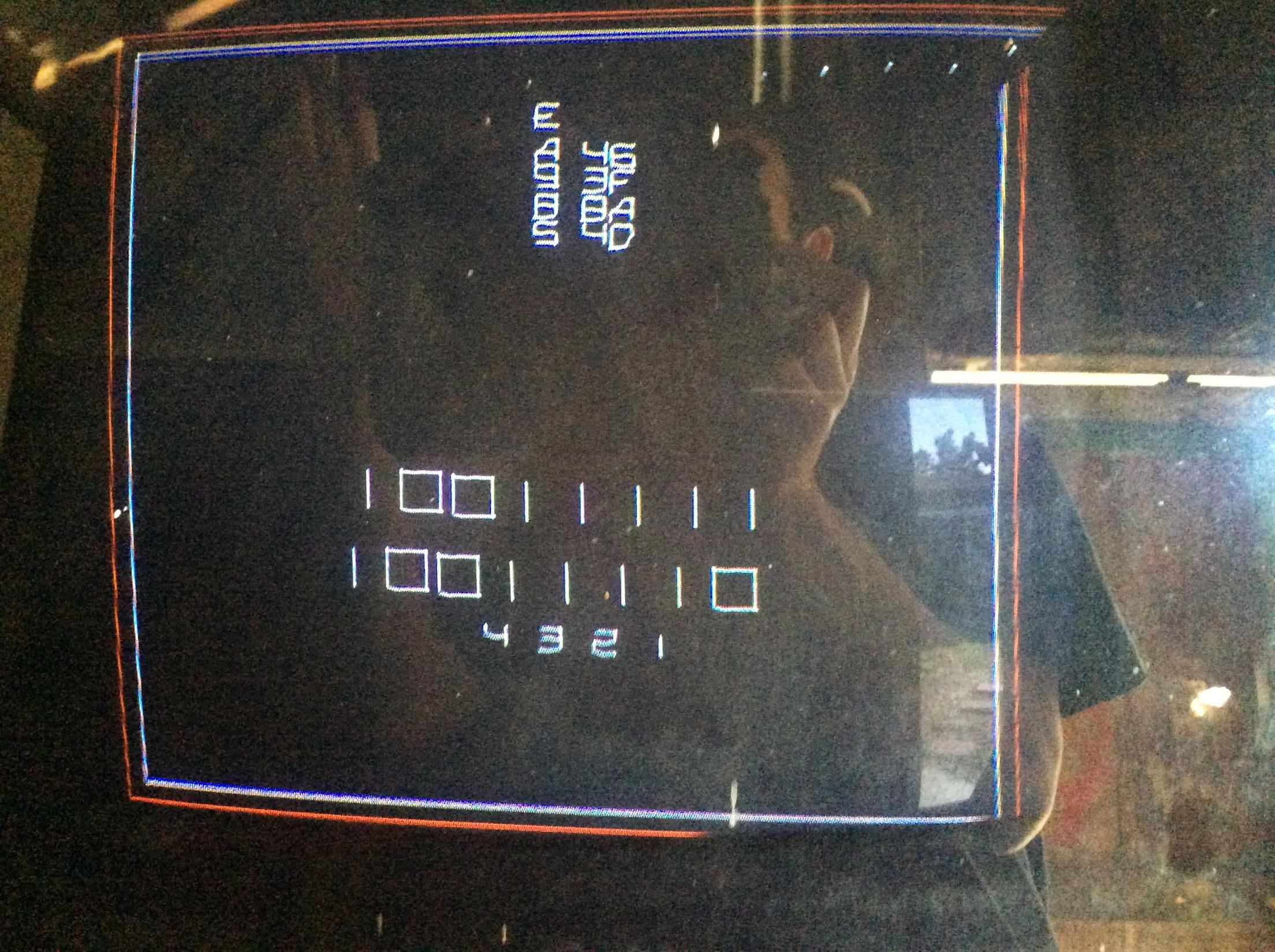

I finally installed my working 6100. I'm having geometry issues that I hope can be adjusted out. It looks like I'm getting a few errors in self test. Test screen 3 doesn't seem to have a "shrinking white box". It's tough adjusting he pots correctly without having one of those 6100 extension cables, going to have a buddy be my eyes. Here's a pic of the errors I'm getting.

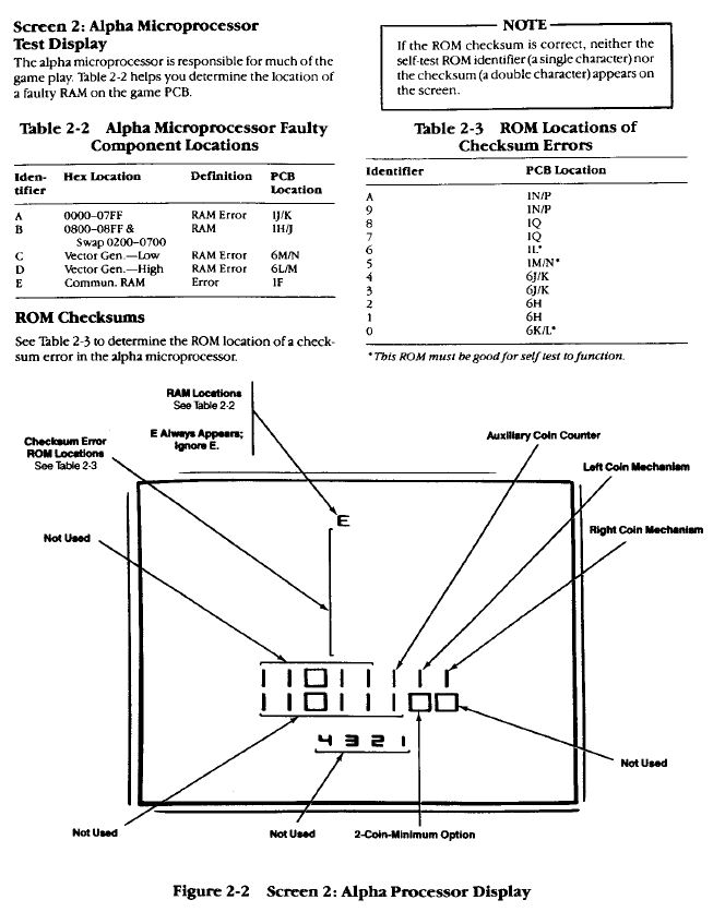

Flipping the pic correctly, we have -
Reviewing the manual, we have -
So, yes, ROM checksum errors? :(
NOTE TO SELF: "ignore E". LOL
It seems my issues are related to roms 1q,1m/n, and 1n/p. I pulled and tested them on romident, it doesn't seem to match any known mame romset. I'm using the return to vax roms, every other rom seems to check out ok. I noticed theirs a split pad between c192 and c193 that looks as though it had a little solder bridging the pads but after using a wick it seems that it's supposed to be bridged. Can anyone confirm? these roms are in close proximity to the alpha CPU, can this issue be related to the alpha being a 6502 instead of a 6502b? I know others are running return to vax, should these roms verify on romident or is it not part of mame?

Ok I reprogrammed the problematic roms and although they now verify on romident, I'm still having errors in self test. While it's the same roms giving me issues, some of the letters/numbers on the right have changed. Here's a new pic.

Are you saying it's expected to see these errors using the "modified roms"? Everything seems to be ok except the image pot adjustments I need to make. I was able to get the shrinking white box to display by increasing the screen pot on the high voltage transformer.
Yes, mod'd ROMS likely have errors in self test.
Fix the display and play some games. If it does not crash, then OK.
