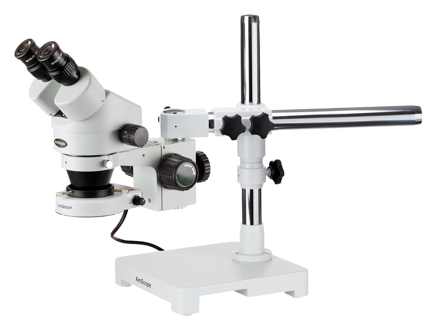

Hold up to the light? Meh ... LOL :)
Glad I bought one of these awhile ago. Best piece of lab bench equipment for debuggin' boards and soldering etc.
Helps find those small solder wisps too ...
Douglas, you got one of these?
Yeah, I bought a couple of those microscopes at my last job. They are really nice, and quite affordable. We did a lot of SMD boards, and they were great for soldering small stuff. I could solder just about anything with one of them, and a fine iron (and no caffiene).
I'd totally get one now, but I don't have the space, and the need isn't as great. But they are totally worth it, if you can swing it. I thought they'd be thousands of dollars, but they're more in the hundreds range.
