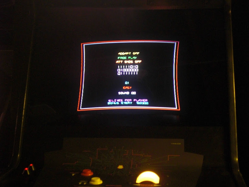

I'm nearing the end (hopefully) of a Major Havoc conversion in a Space
Duel cabinet. I have it up and running, but it seems like there's a lot
of pincushion.
Large pics:
http://www.mn-rocketry.net/misc/arcade/photos/major_havoc_pincushion-1.JPG
http://www.mn-rocketry.net/misc/arcade/photos/major_havoc_pincushion-2.JPG
(smaller pics are attached to this post)
Is this amount of pincushioning normal for this situation?
(Major Havoc conversion pcb with Space Duel adapter pcb and WG K6100)
I understand that the adapter pcb is supposed to be doing some
pincushion correction. Could something be not working properly there?
Thanks,
Alan

Fixed it. There was nothing wrong with the adapter board; Atari screwed up the Major Havoc board right from the get-go. Long explanation below:
Moral of the story - Don't assume that Atari was infallible
(or, Garbage In, Garbage Out)
While I was supposed to be writing a report this morning at work, I sat looking at the schematic for the Major Havoc to Tempest adapter board (not having one for the Space Duel version), followed by sheet 8B of the Major Havoc schematic, followed by the MH pinout, followed by an Atari service bulletin on Major Havoc.
To summarize, factory jumpers are added to the Major Havoc board to bring a "pre X" signal to pin N and a "pre Y" signal to pin M on P18 (cutting those two pins from the ground pad). The normal "X out" (P18 pin 9) doesn't connect to anything on the adapter board. The normal "Y out" (P18 pin L) connects straight through the adapter board. The adapter board does its pincushion correction and generates "X out" given the two "pre" signals.
First, I decided to assume that the adapter board was fine. I then realized that if the adapter board was getting pre-X and Y-out but no pre-Y, I'd probably get a picture, but without any pincushion correction. Once home from work, I took a look. The pre-X was correctly jumpered to pin N. However, the pre-Y was jumpered to P20, pin D! That pin connects to absolutely nothing on the adapter board. This appears original; pin M had never been cut from the ground pad. So, pre-Y on the adapter board was actually connected to ground.
So, I cut the errant jumper off, cut the trace to the ground pad at pin M, ran a new jumper to it... Presto! I have pincushion correction and a much spiffier picture.

Here are two pics showing what my Major Havoc looks like when the pincushion correction on the adapter board is working properly. Quite a difference! Compare to the pics attached to my first post in this thread.
Alan
