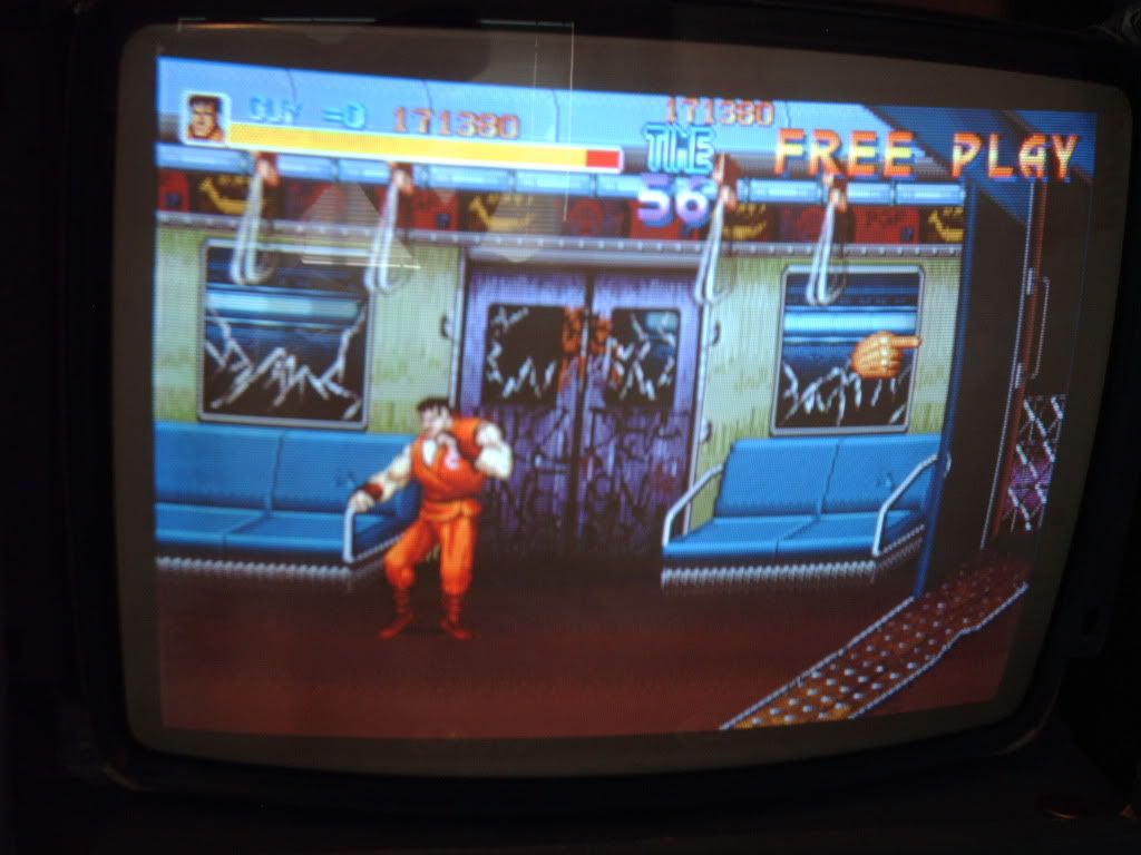

Here is a pic of a normal CPS1 game
Here is Magic Sword, same monitor settings
Well, you are correct Womble, I threw the tiny C board into another CPS1 game that was close to the same chip and the problem traveled with the board. I buzzed around the board with my meter, but I could not find a fault. I guess I need to find another Magic Sword C board and I'll be in business :) Getting closer!
