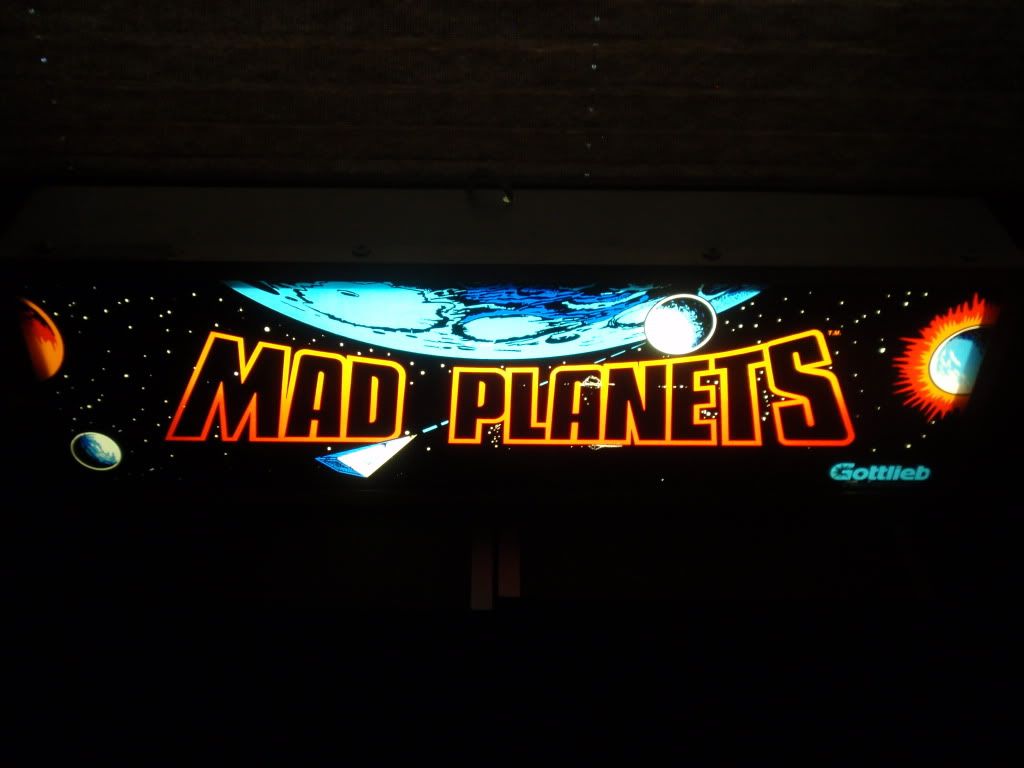

So I finally got around to tying up another loose end that's been dangling over my head like a 3 day old ball sac. A light box for the coolest marquee in the world, Mad Planets. I started this project about a year ago and then just lost interest. With my mural complete and a party on Saturday, I decided to finish her up. I painted it in oil-based 'Aluminum' from Rustoleum, then used real aluminum for the frame. Turned out pretty decent:
Thanks guys, I really can't believe how long some of these little projects drag on. This will be mounted above my mural when I get some brackets fabbed.
That looks great. Is the box wood? I couldn't tell if the frame was aluminim or the whole thing. Do you have any pictures of the box sans marquee? I've got a few Marquees around that I could build boxes for and I like the way yours looks.

It's wood, but the aluminum paint makes it match the real aluminum almost perfectly. You can see the wood thickness in this shot of the power switch side:

Plus, each one takes about 4-5 days to build. Cut the lumber, route the back edge, staple and glue, let glue dry over night, sand and prime, let primer dry over night. Paint 1 coat, wait 2 hours or overnight, paint second coat. Install light fixture, cut and strip wires, add power switch, wire it all up and staple all the wires inside. Now it's on to test fit the aluminum, cut each of 4 pieces to length while mitering the corners. Then grinding and de-burring each piece, then measuring and laying out the screw pattern and drilling 12-16 holes, then more deburring. Now time to test fit the marquee and screw each piece of the frame in, grinding any corners that don't quite line up. In fact, in the close-up pic, you can see one of my corners is off, I grabbed the wrong piece that was laying there, as I had cut a few at a time. I need to take it off and install the right one. I think the length difference was like 1/16", but it makes a difference.

I have a question: what's the best way to treat a marquee that you'll be mounting in one of these types of boxes that you're using a scratched marquee in? Can you tape a layer of tissue or waxed paper on the back side of the marquee to diffuse the light better so the scratches don't show up as much?
I only ask b/c I have a few marquees (like Colony 7, for example) that I will probably NEVER use in a cab, but it would be great to mount them in a shadow box. There are a few scratches, though, and I'd like to lessen the effect.
In black border areas, I suppose you could mask it and spray with krylon. But That won't work in the majority of the artwork area.
Install white self adhesive privacy window vinyl or spray a light coat of white Krylon Fusion over the back of the marquee
