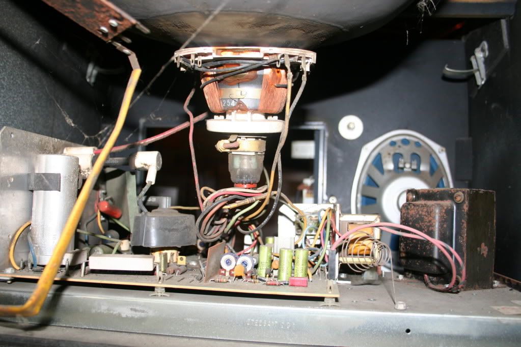

Does anyone have a m5000 that they could snap a pic of the 4 wires going to the yoke? I'm having an issue with a SID and a couple people suggested here it's probably a yoke wiring issue. I can tell someone took the tube out (the cut the anode wire) so I guessing they didn't hook the Red, Green, Black and yellow wires but up properly.
I've look at the schematics in the manual and all they say is 'to yoke'.
Thanks!

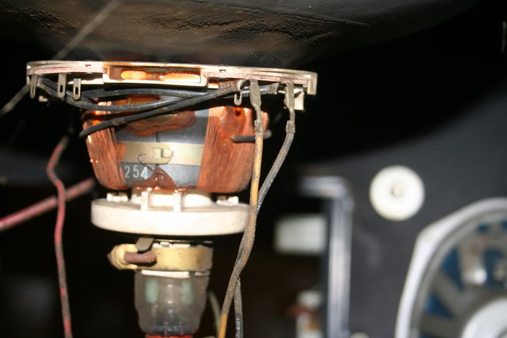

It looks like the yoke was nicely cleaned...
I only have the red marking left.
On the RED side there are 2 spade connectors that line up with the red marking...What I would call the inside and out side connector. Does it matter which one? I can't quite get my fat head in there...I'll probably pull the tube this weekend
I'm fighting a Horizontal collapse...from what I've read and been told here if I have HV (which I do..measured at 73V and the 'squeal') it's probably a connection problem to the yoke.

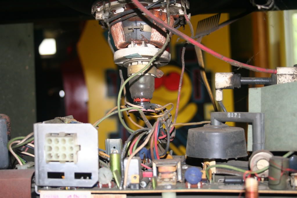

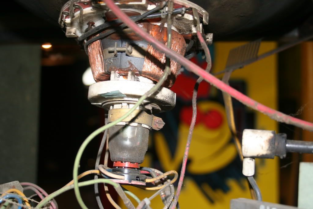

So it does look like I have the wiring correct. The horizontal coil looks to be good I did have some burnt trace issues on the bottom of the board. The one solder pad was lifted but..it looked like it was just an anchor as it didn't have a trace attached to it
Anyone know what the item is to the left of the horizontal width coil is? About an inch tall and about 3/4 in diameter..that also had some burnt trace issues.

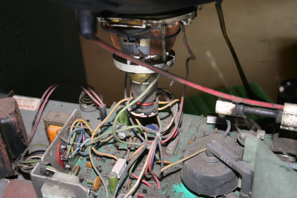

I think the problem is in a small coil next to it. It looks like another coil with 2 wires coming out either side..those wires are then solder through the board. I have no continuity between the wires...I'm assuming I should. Is that another coil of some kind and are they available for purchase?
I'm half tempted to take it apart to see what it looks like
In the second pic you can see the small groves in the left and right side...coming out of each of those is a small copper wire that go to the board
Edit:
So tracing the back of the board the circuit comes out of the width coil...into the mystery coil..through the mystery coil...and continues to the red yoke wire. Me thinking this thing is bad

That's the horizontal linearity coil. Unfortunately, the manual really doesn't give a value for it. You should get some kind of reading between the two connection points. It's a fixed inductor of some value.
I don't know of a source, but the manual just calls it by the Motorola part number - 24D25248A14. Unfortunately, no other designation or values printed that I can find.
Perhaps someone else has more information on this part? You might be able to track one down off a parts chassis. Or, if someone has a good monitor, and an inductance meter, they should be able to determine the value in microhenries - you might be able to get something close. I don't know how value critical that part is in this monitor.
If you can figure out what gauge and how many turns of wire, you should be able to re-wind it...

Well I took the coil apart and found a coil busted...fortunately I only had to unwrap it twice.
I ran a couple jumper traces to repair the smoked ones...
And looky what we have here....
I'm still gonna try to hunt down a new one
Thanks for all the help guys...I gonna blast some invaders!
