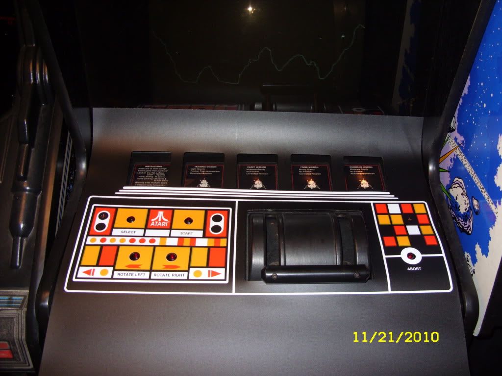

Lunar Lander cpos and plexis now shipping at Phoenixarcade
Full wrap cpo with plexi undermount. Both screen printed from Scotts Atari films. Rich worked like a dog on this for me. Thanks to Chris Rhoades for loaning me his panel for the die.
Those that placed orders already will ship tomorrow and Thursday.
Hopefully my webgirl will get these added quickly to my website.
Thanks!
Darin

Those are nice..but there is some color bleed on the edges of the squares. Not trying to be an ass or anything..just thinking its not quite 100%. But they are really nice if you have a terribly rusted CP.
First since we used the ORIGINAL Atari films the art itself is 100% accurate.
so heres the difference you see:
because this was done as an overlay the colors and films were all screened in reverse order.
Rather then direct surface printing.
which used a different type of ink on the metal panels.
so the bleed you see is actually the same bleed you have on the metal panel
its just not as noticable but if you look closly at the orginals youll see a bump in the center of all red and orange squares which is from screening a white base underneath.
I matched up the films including this white underbase on an orginal panel to be sure the art itself we were using was 100% the same.
But on the overlay its just the opisite and the inks for the polycarbonate are not as opaque.
even though I double printed both colors so you see what looks like a bleed rather vs the brighter colored bump on the orginal.

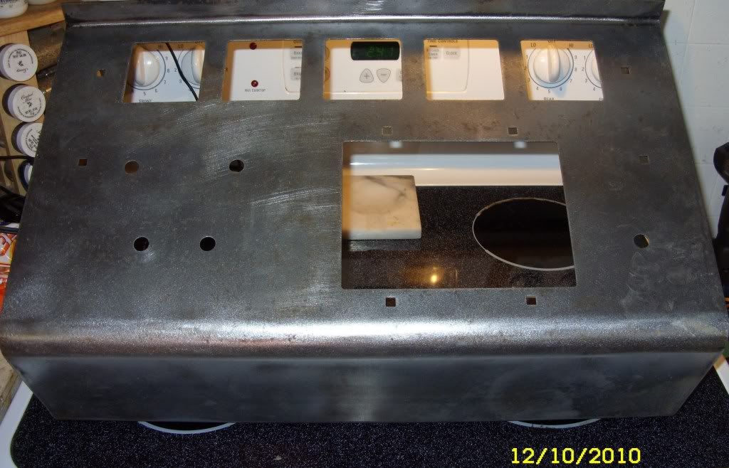

Im having my other panel blasted to get ready for this CPO:). Its a rusty mess.

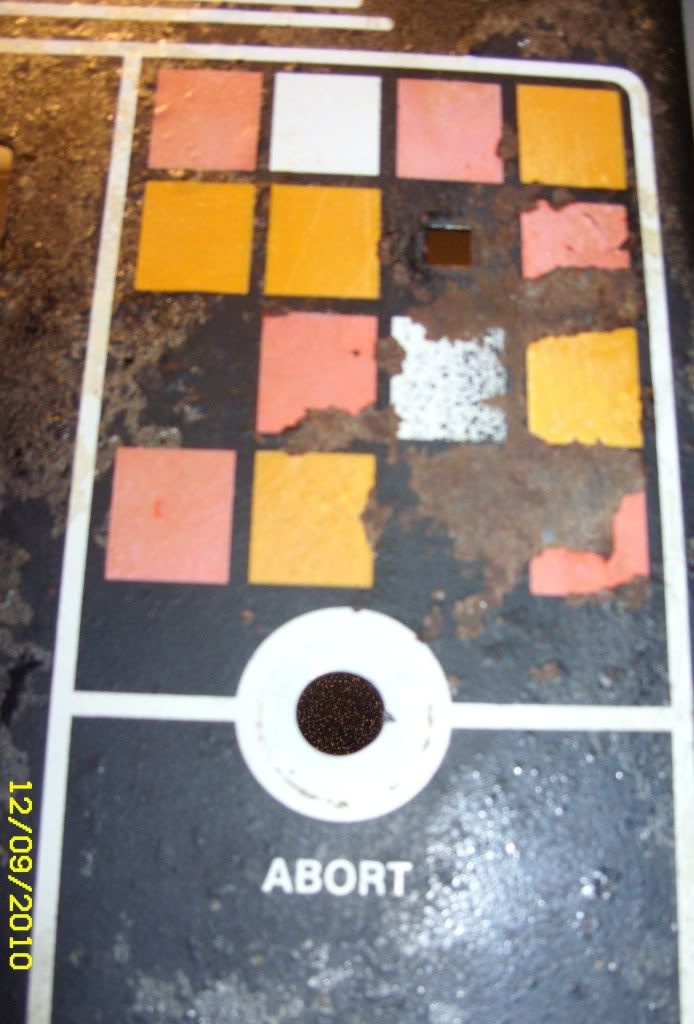

I started work on my spare panel. I hope to have it almost done this weekend. I will save most of my pictures for a restoration thread, but I wanted to show how bad this baby needed a overlay. Rust had eaten all the way down to metal in many spots.

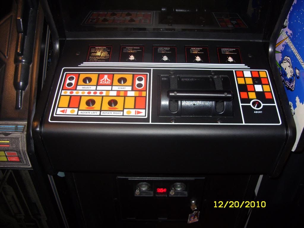

Panel is 100% complete now :) I put it back on the machine tonight. Looks awesome!! Thanks again everyone who made this project happen!!
