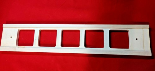

Does anyone repro the wooden backing for this that separates the light PCB from the mission plexi?
I know the light PCB is available (if you've got coin...) And I do need one, but I'm not sure where to get the wooden spacing piece.

No longer available :(
There are threads here about that guy. He's either making them, or has a lot of them. They just aren't always posted, but he's been selling them for a while.
It's worth messaging him and asking, as I think he likely will still be able to get you one.
