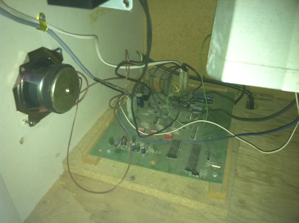

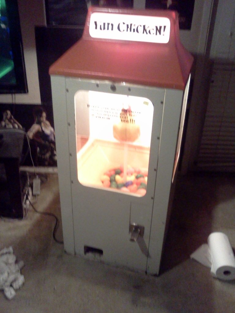

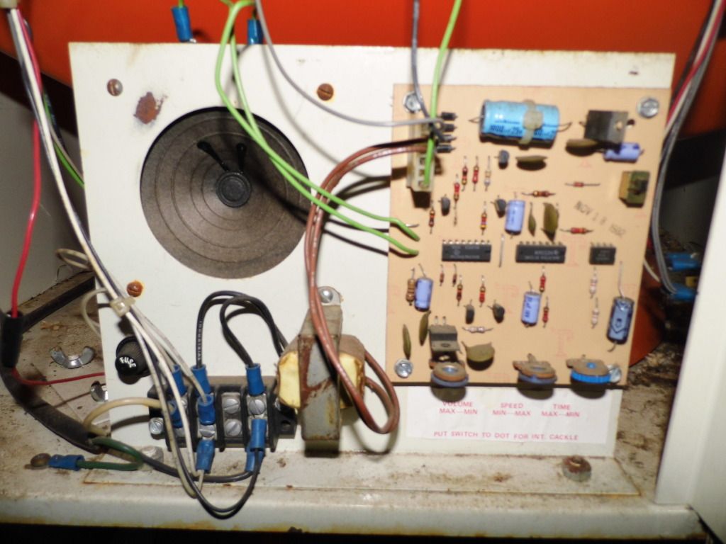

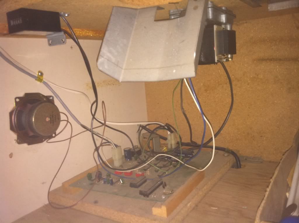

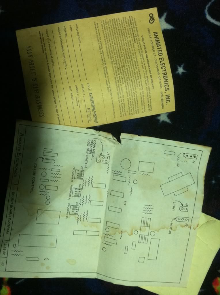

Here's some pictures I took of my Flintstones lucky egg machine and the paperwork it came with hope I can help? Sorry for the crappy pics they were taken with my camera phone.

Brad. As soon as my charger for my camera turns up I will snap some pics. As far as the schematics, I can scan them and post them here. The board is fairly simple. and if you need any help once you get the schematics let me know. For starters the first thing I did was disconnect the plug on the board and activate the coin switch. you have to toggle it. The chicken turned and delivered an egg. just no music. From what I gather, the board is only there for sound.
Let me know how that works out.
