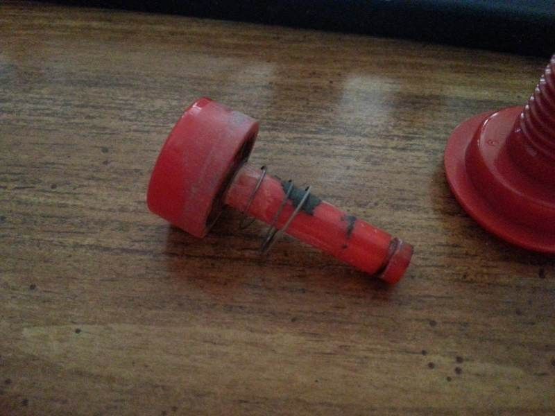

Would anyone weigh in on lube points for a Wico leaf stick? It looks to me like the center hold in the grommet would be the main spot. Curious to hear any other tips for these.
I would not normally lube a Wico leaf stick. They weren't designed for it, and there's really no need, as there aren't really any friction points that require it.
The only exception is if you have the occasional stick that squeaks. This can happen from the spring rubbing on the shaft, or the shaft rubbing on the grommet, in which case I might rub the shaft down with a tiny bit of silicone grease, but then wipe it off, to just leave a coating.
You don't want to use any lube that will attract dirt and crap, and/or that will get the leafs dirty, if it seeps onto them.
If your sticks don't feel good, the best thing to do is to clean all of the parts in warm soapy water, dry overnight, and reassemble. You can soak the metal parts in white vinegar for 24-48 hours, then scrub them with a wire brush to remove any rust (or tumble them, if you have a rock tumbler).
You can also use steel wool on the shafts to clean off any light rust, or chuck them in a drill and use fine grit automotive sandpaper if they're really rusted (640, 1000, 2000 grit, then a final buff with metal polish will make them like new again).
