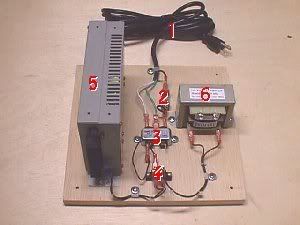

That chassis has new caps and it looks like a "good" flyback. Flyback appears to be a late model replacement. I'd be very surprised if the flyback blew. You did use an isolation transformer in that cabinet right?
I replaced the chassis and still have the problem. I didnt build this unit myself or anything, not sure what an isolation transformer even looks like.
Root, ill look for that later today.
It's number 6 in this picture. It isn't always in this exact configuration, but most of the time its the biggest part on an arcade power supply and it sits on the bottom on the cabinet somewhere. Most arcade monitors require this to operate. Never plug an arcade monitor directly into the wall, because it'll usually fry without this. The only reason I mention this is because Nintendo monitors have a nice looking plug that looks like it's made to plug into a wall- just DON'T do it. They barely ever go bad- it's usually something else thats wrong with the monitor.

Ok the isolation transformer is present and accounted for. I just bought a replacement power supply to see if that is the issue.
