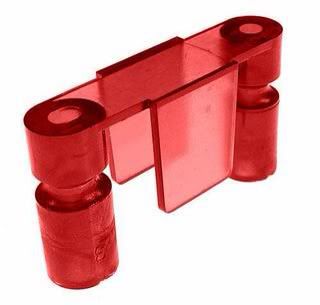

I don't ever seem to remember the ball getting caught between the Balrog and the pop bumpers at the arcade, but mine is getting caught there constantly and I've got to wait for a ball search to release it. Annoying. Anyway, while looking for other things at Marco, I came across this. Says its for LOTR, but doesn't say for what. Is this a replacement part to prevent the Balrog from trapping the ball?
Is this a joke or are you being serious? That is a lane divider between roll over above the pops.
Was completely serious. Looked like it had those dividers to keep the ball from going through, and looked like it would fit right in.
Are you missing any of the plastic protectors around Gandalf or any of the other posts? I've never had the ball catch between Balrog and the pops except once when he swung back to open the ramp, and trapped a ball. That should be as rare as when he traps a ball behind when he swings to block the ramp.
- Don
Issue resolved! A no brainer too. I was missing the rubber ring between the posts. Oiy.
