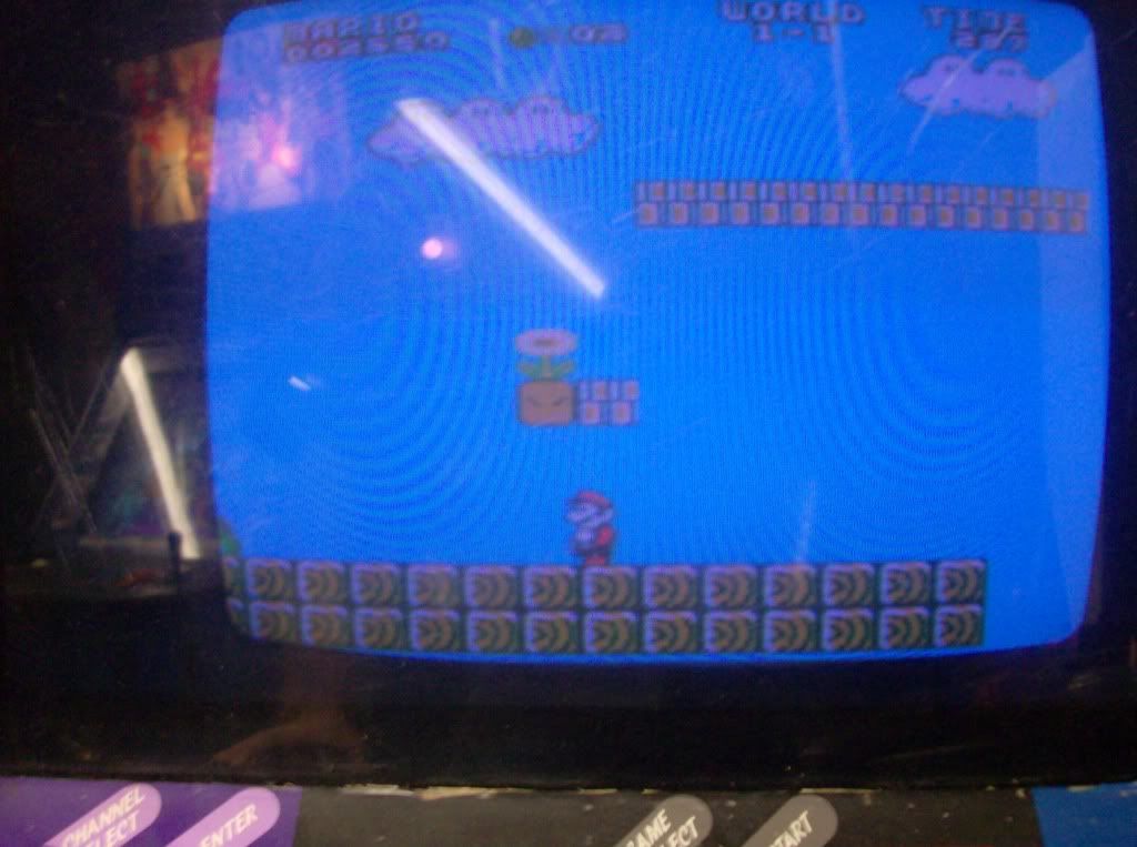

so i tried this
smb with mario 3 graffix (sweet)

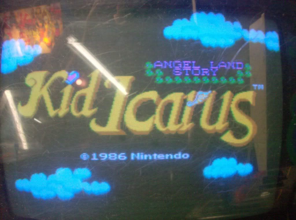

got kid icraus up n running on my pc as well

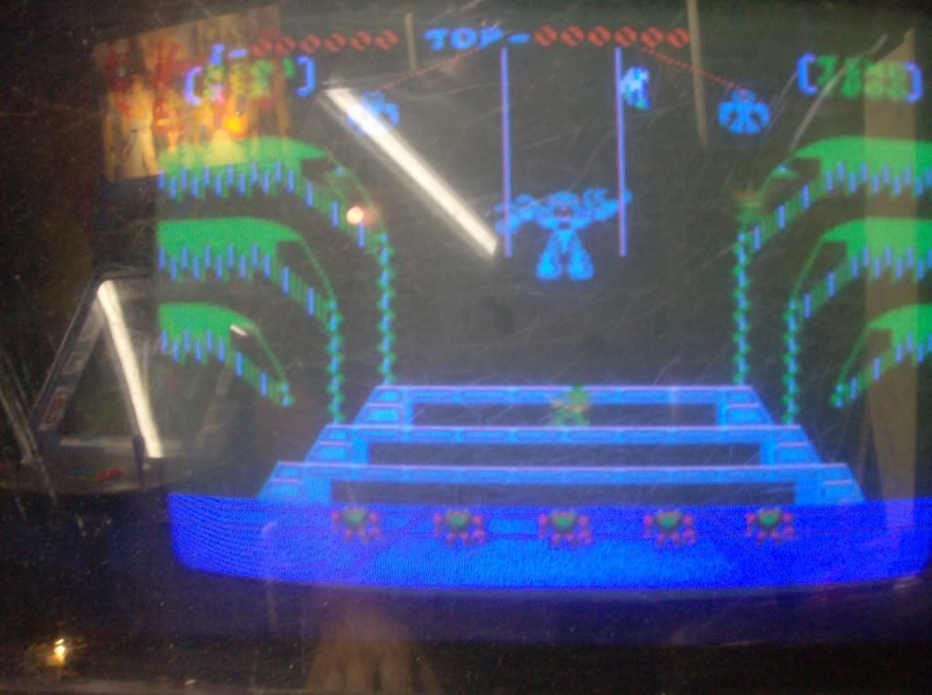

and a hack of dk3 with robots instead of dk and jumpman
(not to sweet but a nice chane of pace )

too cool. what kind of job was it to get original kid icarus to fire up on that?
just burn and go?
yup burn and go kinda
well first you have to turn the .nes file into the 2 files needed
using this app romutil its last app on bottom of this page
http://home.mchsi.com/~gamehacker/Playchoice10.htm
then use the pdf file here under downlaods its the spread sheet
http://playchoice.riemen.net/modify_board.html
that will tell you what size roms you need (so when converting .nes make shure you pick right rom size)
then the big kicker is you need the version of rad racer with sram
(pics here to tell if ya got wat it takes lol)
http://playchoice.riemen.net/mod_variations.html

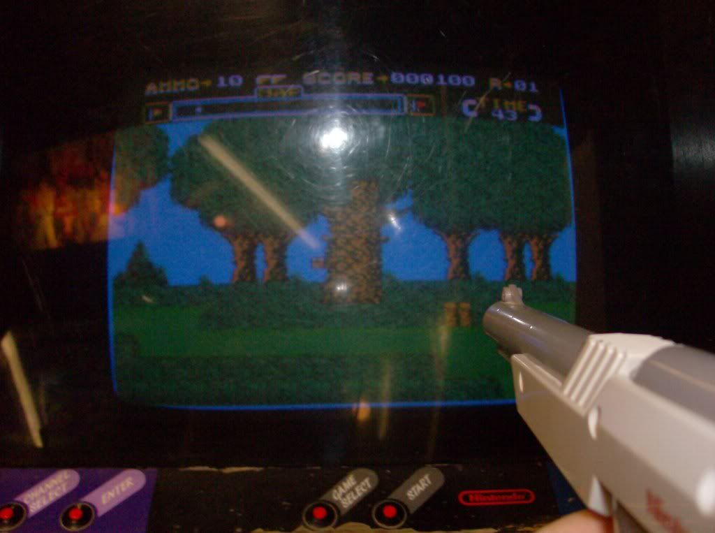

converted gradius(track n field) to gotcha(never can have to many gun games on the pc 10)

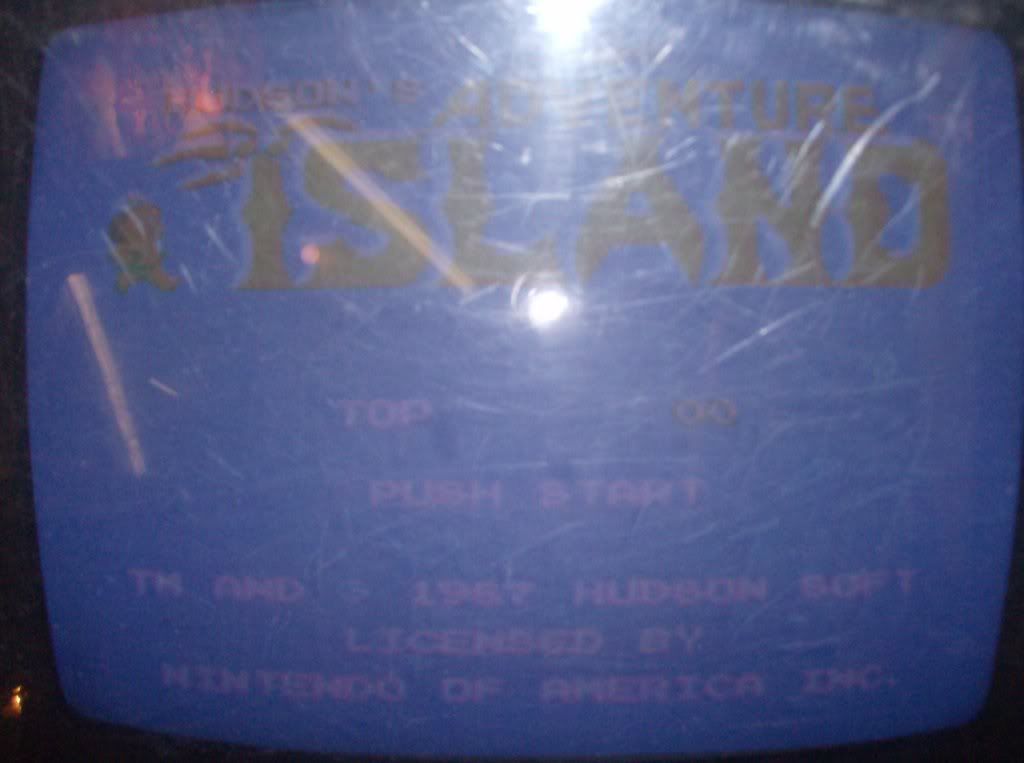

converted gradius(track n field) to hudsons adventure island
i forgot how much fun this game was

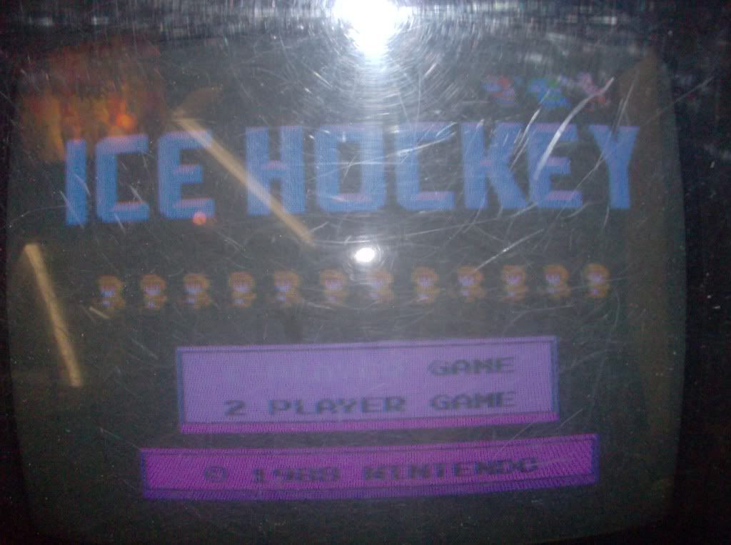

since my smb cart seemd to be having problems with my board converted it to ice hocky and it works great now
