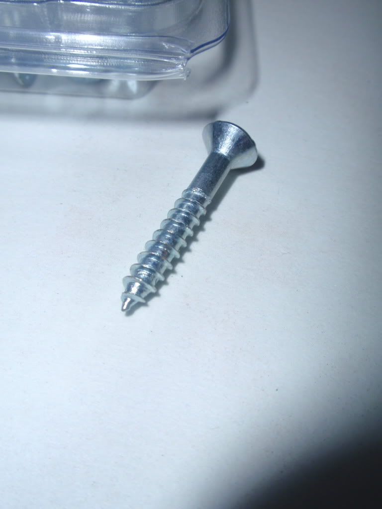

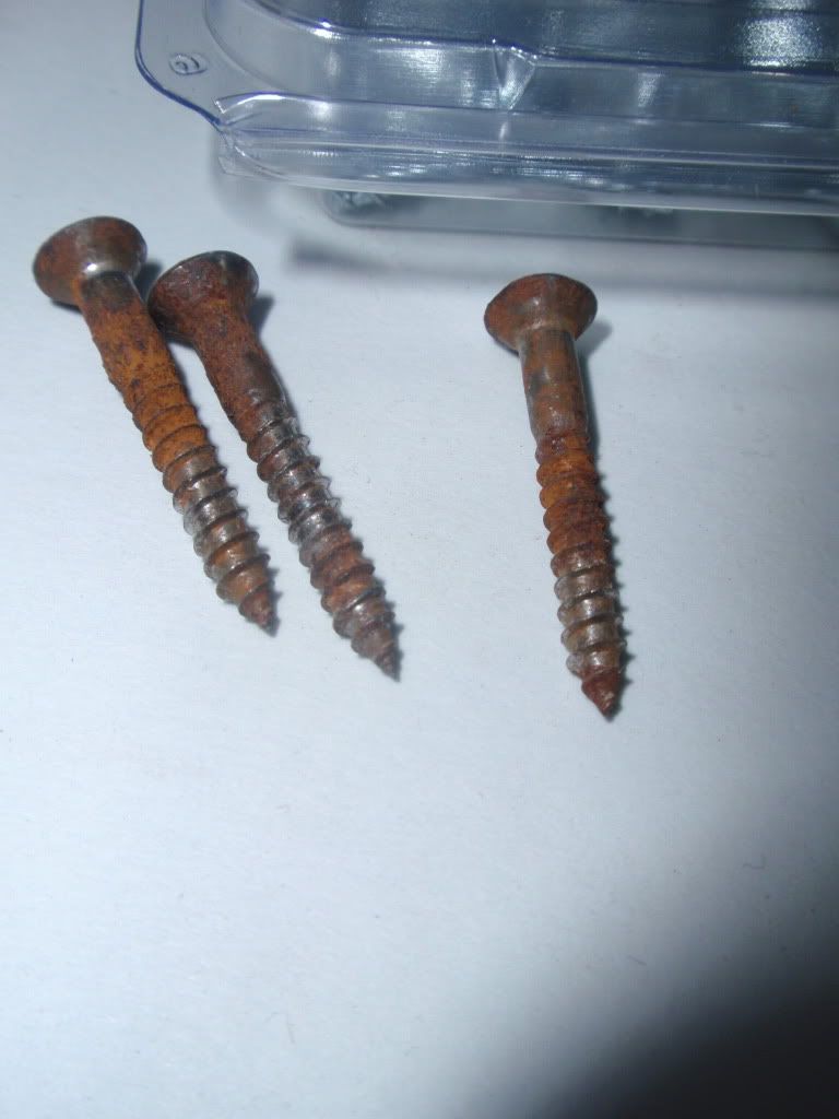

I hope this helps someone restoring a GORF in the future. I decided to try and replace the original wood screws that hold the upper cab to the lower cab, as mine were rusty and just looked like hell. Here are the original rusted fucks:
First I tried replacing them with standard 1 1/4" Black Oxide sheet rock screws. Well, they sucked. I could tell when installing them that there wasn't really enough shaft thickness and thread to screw in tight. They went in too easy. So I hunted for the right screws and found them:
And you can see the old ones in comparison:

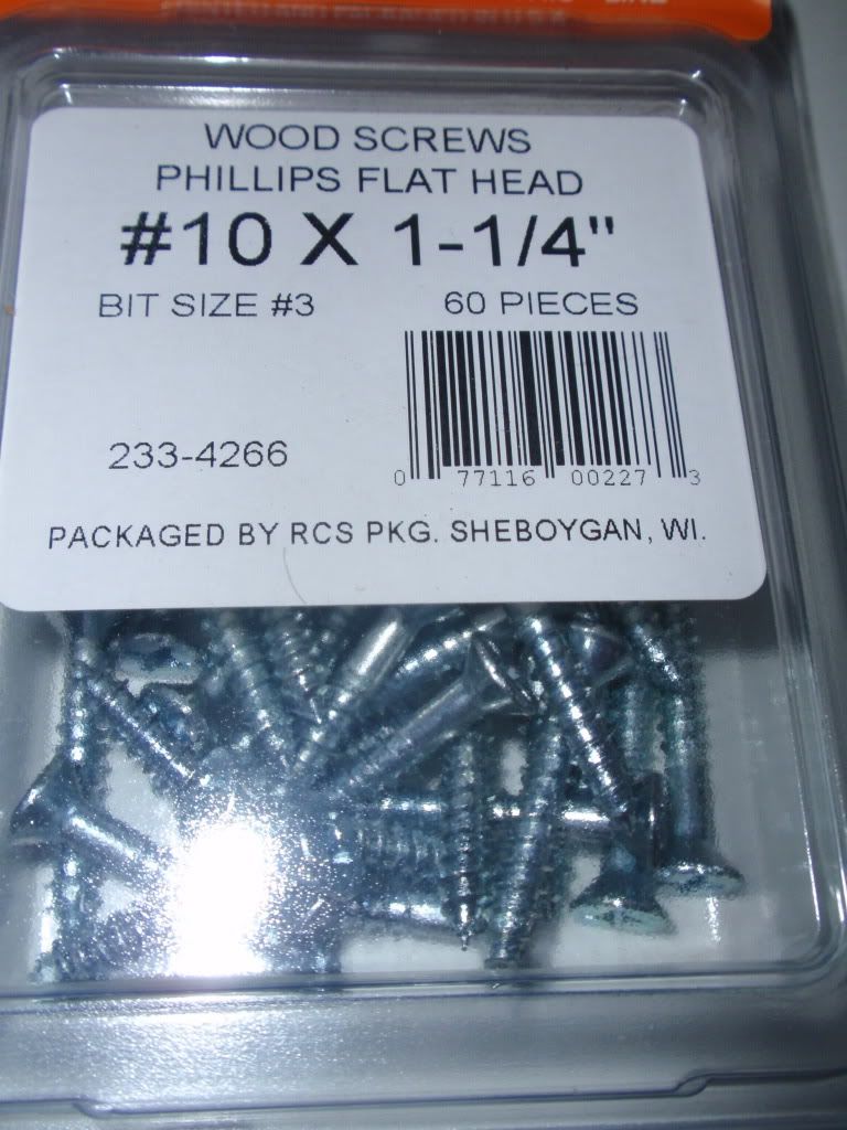

So, there you go. # 10 x 1 1/4" Phillips Flat Head Wood Screws (#3 bit). Make it easy on yourself.

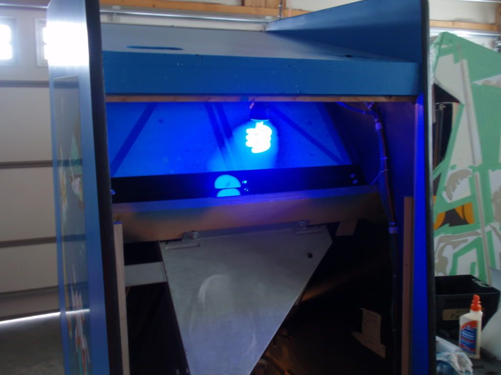

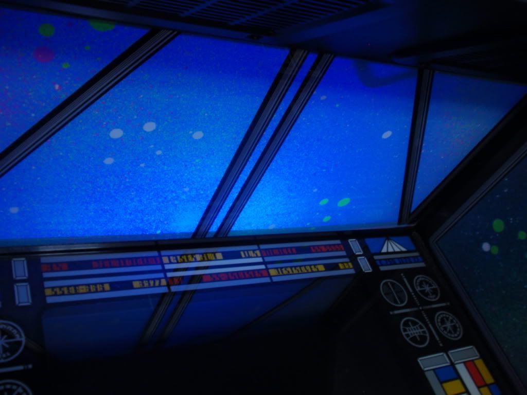

I also noticed that after installing a white 40 Watt CFL in my back-lighted monitor marquee, it seemed a bit to bright/stark and caused a reflection on the actual monitor glass. I decided to try a 40 Watt Blue CFL (not black light). I think that did the trick. Still glows right but cuts down on the glare.
Before:
After:

The little tidbit that I wanted you to get from this thread was that the fucking screws were made in Sheboygan, WI. Didn't you date a guy from there when you were still living in Madison?
Another idea for the back light would be 25w replacement CFL's which run at about 4w... they are a little harder to find, but they're nice and don't put out as bright a light.
Another option would be to shoot a quick and light layer of paint on the CLF bulb.... don't lay it on... more like a light "splatter" type pattern... it will cut down light significantly.
That said, the blue in that cab does look awesome.

Thanks Fritz, I may try the blues in the lower marquee area as well. I like the light, but it would be better as a glowing accent rather than a harsh spot light.
