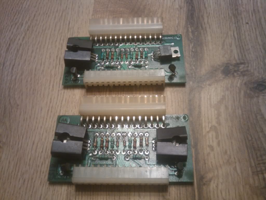

They also put the overvoltage protection on a daughterboard that plugs in between the Defender PS board and the wiring harness. It is documented in the Stargate drawing set. I have only seen two of them in person. Most of them were tossed by operators that didn't know what they were and thought they were filters like Midway used on Galagas. Just another thing to break, so toss it.

Is that what that is? I have one or two of those mounted on a power supply in my "Box of Williams' Power Supplies"...
If they look like this:
attachment.php
That is what you have. You will probably recognize most of the same components that are on the Joust & later PS boards. The two components in the heat sinks are the SCRs and in the center are the zener diodes that comprise the bulk of the overvoltage circuit that was added to the later PS board.
They don't have a lot of value, but they are rare.
ken
