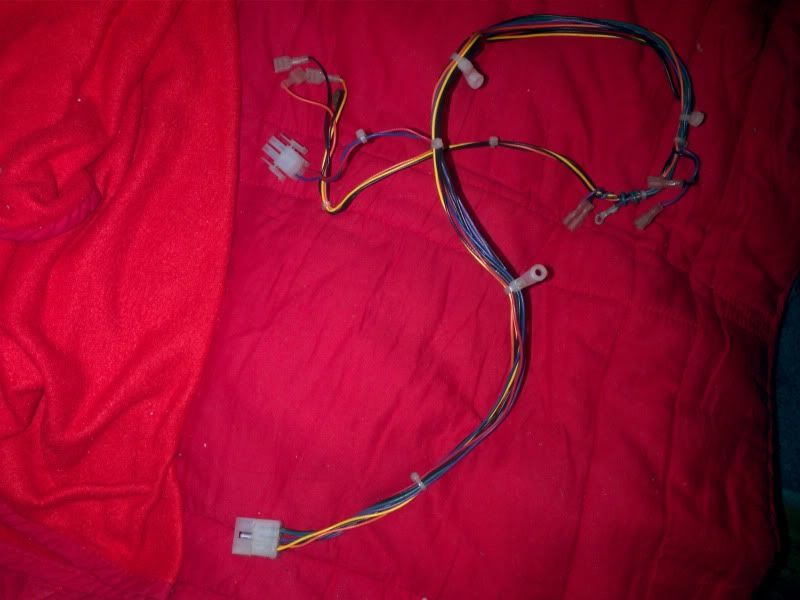

Can someone point me in the right direction or possibly suggest an alternative to light the i reject buttons without using the wiring from a jam a harness? My harness is a little messed up (previous owner did some kind of hack) and I cannot light the bulbs using the 12v or 5v. Is there any way I could retrofit some kind of led light that just plugs into a standard outlet? I tried radioshack and they have led bulbs that use batteries. I want something more long term. Any help or ideas are appreciated.

These are the wires that were originally hooked up to my coin door. The molex connections do not fit my PC power supply.
Uh... yeah. They're not going to. But that's where the soldering iron comes in. Either find a suitable mating plug for one of the PC power supply connectors to put on your harness (easily scavenged from a dead hard disk, or one of those fan "Y" adapters), or just cut and splice.

The little pink single-wire connectors are called "quick disconnects" or "QDs". There appear to be 8 of them. 4 were likely connected to the lamps (2 to each lamp). The other 4 were likely connected to either the microswitches under the coin mech, or to "lockout coils" which prevented the mech from accepting a coin when power was off (or whenever the PCB didn't want to accept a coin).
There's also a 2-position Molex connector which appeared to connect to something on the coin door--not sure what it might have been.
On the other end appears to be a matrix (grid) style Molex connector. I can't really tell from the pic, but I'm guessing it's either a 6-position or 9-position 0.093" connector.
You could re-install that harness on the coin door, re-connect the QDs up to the lamps, and trace the proper wires back to the Molex connector. To mate with it, you'd need to get some wire, crimp on the proper pin terminals using a crimping tool (not the common type of crimping tool used to crimp on QDs), and insert the terminated wires into the proper mating Molex housing (to mate with the lines you traced from the lamps). On the other end, you'd splice into whatever type of connector mates with your PS, at the proper voltage for whatever bulbs are in the sockets.
Or you could leave that harness out of it, and make you own wiring from the PS to the lamps.
