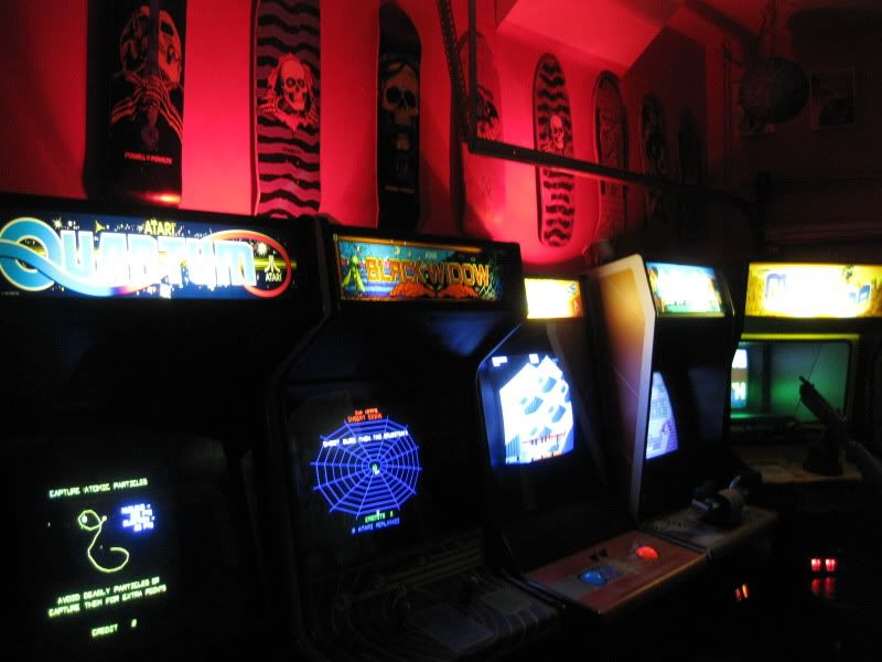

i just used some basic accent lights from walmart. bought some red bulbs and set em up behind the tops of the games. the walls are painted red, the red lights gives it a cool satans hollow feel :)

Off topic comment: That is a sweet row of Powell Peraltas. The McGill was my first skate deck. we went to Woodward together

I like those Powell-Peralta decks on the wall! Looks like a mix of old and new?
