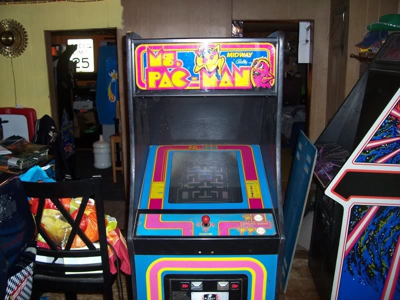

man what a week. got my 2 player Demolition Derby up and goin finally. also got the wife's Burgertime goin and working 100%.....finally...... and also got myself a Crazy Climber pcb with a jamma connection and got that in 1 of my empty cabs and it works great. then saturday i should get my tempest and DK boards back so both them games will be back up and goin...... then earlier tonight i went to an auction and scored a sweet condition Ms Pacman. i haven't even cleaned it yet....lol. got it for just over 3 bills and it only has 1 glitch i gotta figure out.....last pic will show the glitch. it's all the moving objects, so if ya know what will cause the glitch please let me know....thnx in advance.
What a nice looking ms pac I think you got a good deal. I do not know what the prob with the vid is but worse case you buy another pcb and you are 400ish into a real nice example of a ms pac.
I am not a big pac person but even i would pick that up. nice score.
nice score! Hope the tempest works again!! i was bummed as bad as you when it croaked,
I know there is a repair log somewhere online that shows screenshots and tells you the fix, i bet a little searching will turn it up!
Check all the ROMs at 5E and 5F, make sure they're fully seated and the legs are in good shape. Put it in test mode and see what might come up too. I'm going to guess it's the final buffers in row 2 or 3- they're ceramic chips with heat sinks glued to the tops.
Wow, that just shows how bold the blue and magenta are "supposed" to be on a MsPac! That one looks extremely good except for that upper spot on the left side, but you could repaint just that one area of magenta and it wouldn't be noticeable if the color was a good match.
