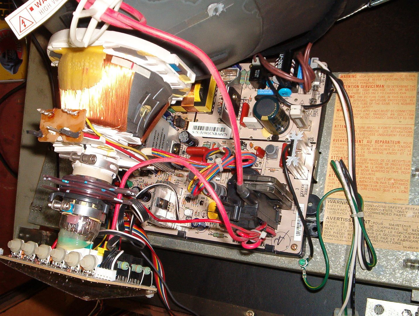

Thank you in advance for checking out my issue.

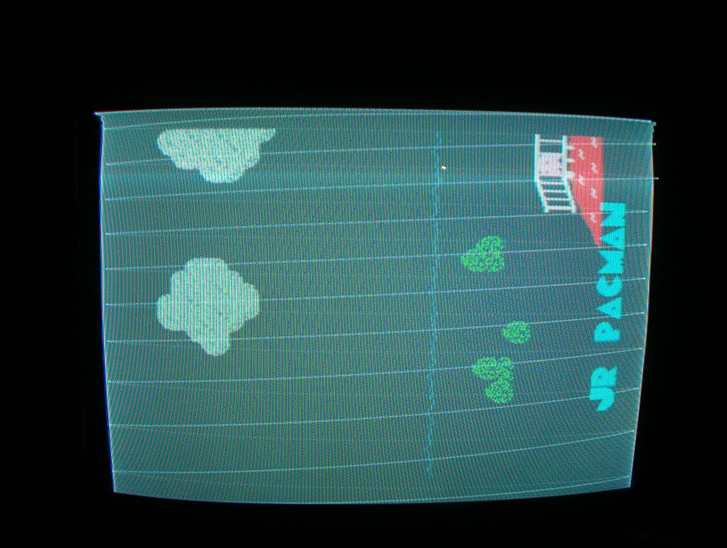

This is a newer LG Monitor ('07?) that is throwing lines across the monitor regardless of the game connected. Adjusting the brightness helps, but then it will jump to an all black screen before the lines disappear. I cannot recall the model (just noticed the tail of the model # on the neck), but am providing some close-up pictures as maybe someone can identify where something needs to be adjusted or what needs to be changed as I believe this is an easy fix but was informed it may need a new board (hope not). Monitor has some 50 hrs of use.
Monitor picture
Some additional details.
When you turn the screen drive knob (whatever it's called) on the flyback up, the picture will appear but you can see the scanlines. You can turn it down almost to the point where the scanlines disappear, but it's right on the border. Turn it down any more, and the whole image disappears.
We tried turning the brightness on the handheld adjustment PCB all the way up, and turning the flyback drive pot down, but the image still disappears.

This looks like a version (or copy) of one of the Vision Pro's made by Kortek (even down to the sync selector button).
While it has very low usage, it's possible it was made with some of the bad caps that came out a few years back and were used often by the low-bidders who built these things....

Just tried that. Same thing. Adjusting screen drive down and parked brightness/contrast in the middle. No picture without game signal connector plugged in, no picture with it plugged in. The picture won't show up until it's cranked up. Literally, the whole picture just disappears.

Yea, I was thinking that originally. But the monitor is made in 2007, one would think that it would be past the failed caps, but it's probably a good place to start. I'll ask cyberfluxor to get a cap kit :)
None of the caps are swollen, but that doesn't always tell.
Supposedly less than 50 hours total on it.
Yep, I'm going with Vision Pro.....L/G is who made the tube.

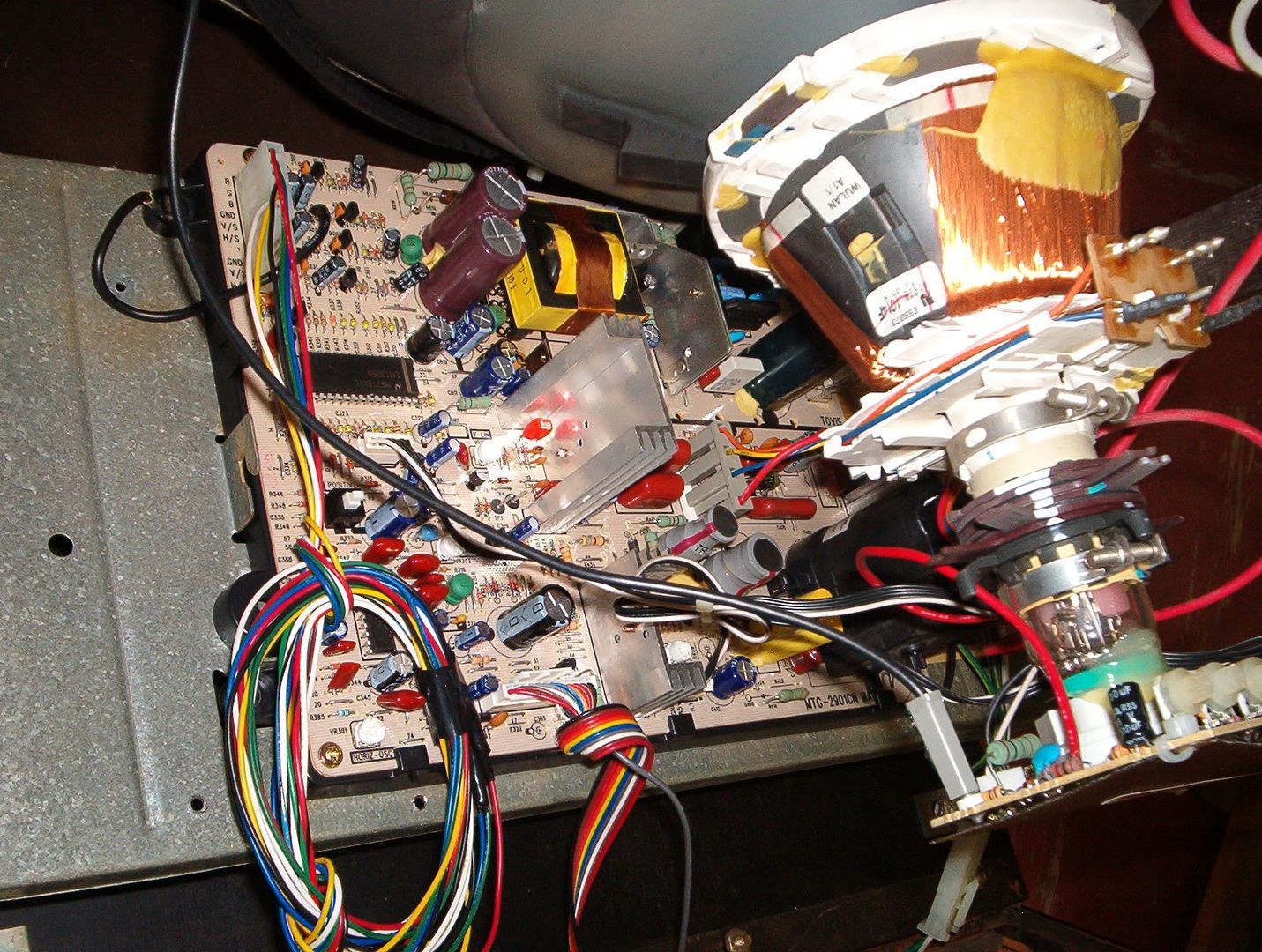

You can see the model number in the one picture...MTG-2901.....also, it's a Tovis re-brand. You can see the Tovis name by the filter cap.

So the fix on the monitor was a transistor replacement, which on the lucky side is a common component so the part was on hand. Two issues persist:

Just a solid detail on the monitor. The 7812 power regulator had been replaced with a cross reference. It was producing ~11.5 volts, which was causing the issue. Obviously it had been replaced in the past. One thought is to add a heatsink to it, if it is getting really warm.
