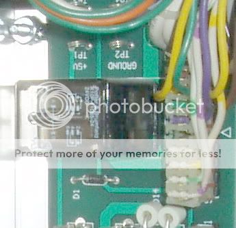

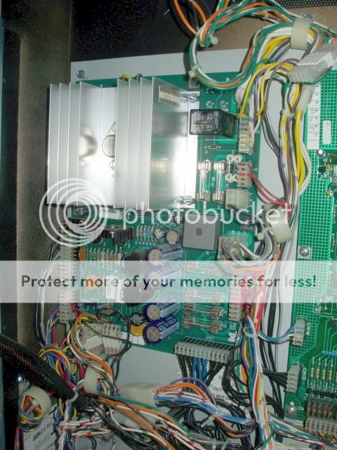

Anyone have GOOD pictures of the power supply board and of the computer chips on the cpu board. I ordered new chips and 2 of them aren't the right size..they have too many legs. I am fairly confident my problem is the power board...the wires are VERY jacked up...they have been spliced and I am not sure which color of wire goes where (mainly the wiring in the top right of the power supply board)
Thanks again.....
Here is a picture of a JP PS. Is should be close enough to a LW3 PS. Let me know if you need anything else, or another angle
That pic is good....I hate to ask but can you tell me the wire color in the far upper right hand (has 8 wires going into it).
Thanks again
Oh, the Infamous GI connector:
Top to Bottom:
Brown
Yellow
Green
Purple
No Connection (key)
White W/ Brown Stripe
White W/ Yellow Stripe
White W/ Green Stripe
White W/ Purple Stripe
Hope this helps:
As long as the solid colors are on the top 4 and the stripes are on the bottom 4, the order does not matter,
