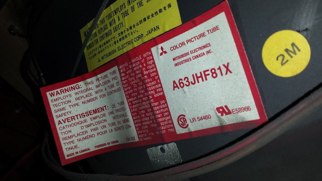

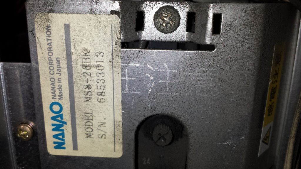

This is the monitor my LETHAL ENFORCERS came with its a Japanese monitor im not familiar with. Can someone tell me a little about it? Is it any good? I would like to find a manual for it too if anyone knows where to find it. Thanks
It's a Nanao MS8-26XX dual res monitor, it can display std res(CGA) or med res(EGA), by switching a connector location and small adjustments.
Manuals are very hard to come by, and schematics are unlegible if you find them.
nanao ms8-26 which sterlingrush on here knows a ton on them.

+1 on that being a great monitor. They dont fail often and when they do they are usually easy to repair. Great picture, really good geometry. Is it working?
Yes it works. I would like to know if there is a focus adjustment of any kind. The picture looks pretty darn good already though. If there is a focus adjustment it would make it amazing.
Right next to the width coil, there's an a/b selector switch(blue). That is supposed to be a Normal/Sharpness option. I myself have not seen a huge difference between the two, but it might depend on the game. Worth a shot.
Post a pic of the image you have now, that could tell a lot. Only real focus options, are what I just mentioned, and the focus knob on the flyback. Other than that, it's just getting the best balance of your colors/contrast/ect....

Expert by no means, over the course of the past year, I've learned there's a few variations that are similar, yet different. Much like a K7000 and undocumented mods, these just don't really have good documentation period, lol. As for the 29's, I think that would be a long while before I get around to that :)
Its looking pretty good. Im going to play it for a while and see if it at least stays like it is. I think its pretty good. Im probably just used to looking at my HD television. LOL Thanks for your help. I appreciate it. I guess my main concern was I had never seen this particular monitor and wanted some opinions on if was a quality monitor or not.
