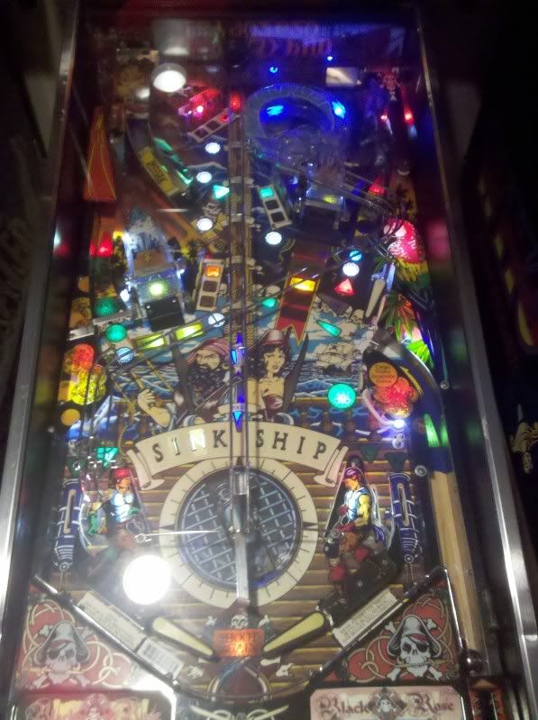

i used to have a BR that was fully LED'd (not by me...bought it that way) and i honestly thought it was too much:

as i stated earlier, i had a black rose that i bought with full LEDs that, personally, i thought was way too much.
