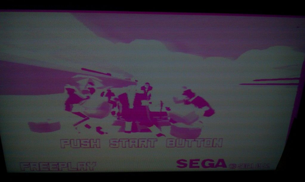

OK, so a fellow gave me his game to throw an LCD tv in on his virtua racing, got the game to sync right away, as the game appears to have just a composite sync wire and a ground for the monitor. The ground does nothing when hooked up really, makes the screen bright, my issue is the following photo, see the dark trace lines on the right of every image? I cant get this to go away no matter how hard I try in menu on the converter or menu on the TV, the TV is an insignia from BB... any thoughts?

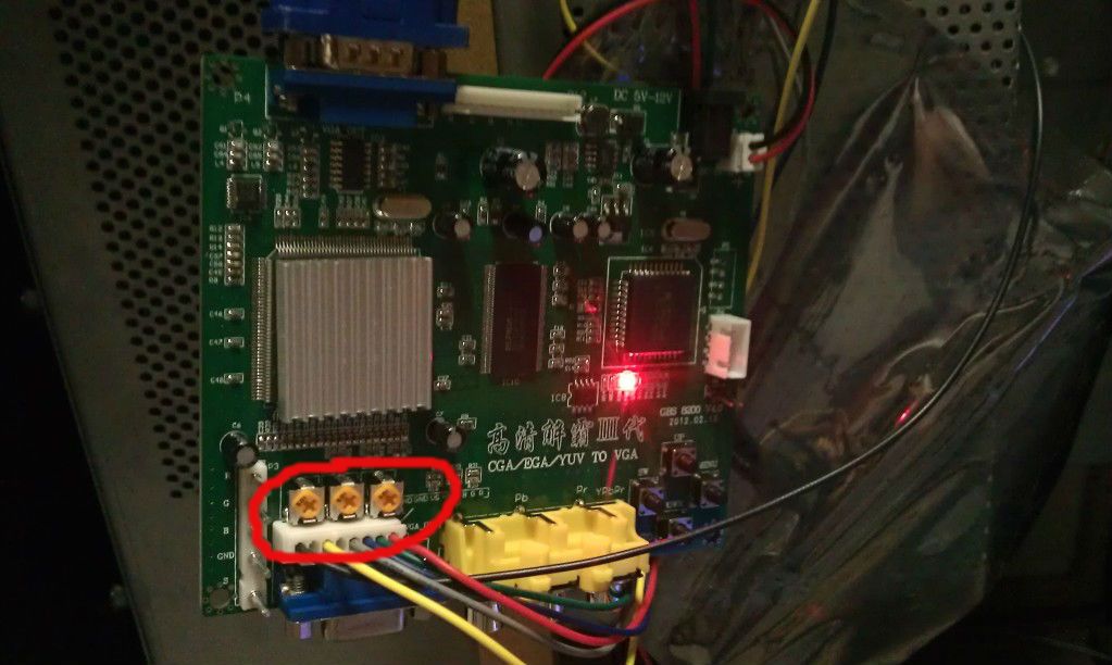

Converter is the board from Nixs at jammaparts.net

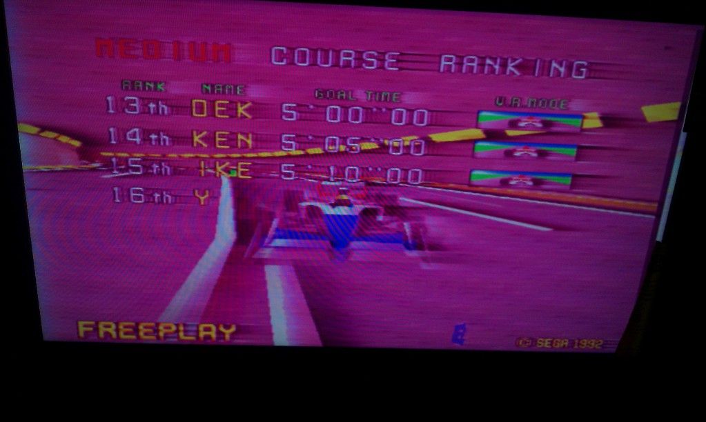

Here is what it looks like now with the video ground connected... brightness will not adjust this on converter board or the tv

Almost looks like the colors are inverted. Is the conversation board upscaling to VGA or XVGA or something? Can you try another LCD monitor to see if you get the same results?
Or maybe a CRT monitor thats capable of VGA (640x480) or SVGA (800x600) to see if you get the same results?
Also, does the conversion board have any gamma or contrast adjustments? Might be too high.

-Just tried another lcd computer monitor, same results.
-Converter board has an onboard menu, have the resolution set to 640x480, the TV autoranges to that even if you change it. The native resolution on the game says this:
Video resolution: 496x384 in 65536 colors
Geometry: 180,000 polygons/sec, 540,000 vectors/sec
Video: Shading Flat Shading, Diffuse Reflection, Specula Reflection, 2 Layers of Background Scrolling, Alpha Channel
Display: 36" 16:9 widescreen CRT
Adjusted the brightness on the converter board with little effect. Colors are correct without the ground hooked up, with the ground on it is super bright with washed out colors on both monitors. Adjusted contrast, brightness, saturation on the converter, to no changes really. This converter is supposed to use it circuitry to auto range I read somewhere, manual is not helpful, at least not to me. Saw a few other threads using this in a paperboy, and it seemed to work fine, also med res monitor game. Ill continue to mess with it, any input appreciated from others who may have used one of these..

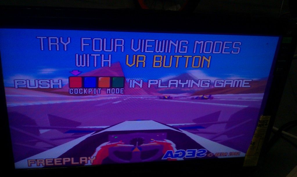

Got it! For future reference,
Get a good VGA cable, the one the guy gave me was brand new, I tried another one I had and bang, solves that. Now for adjustment purposes, now that I have it closer to correct, you can adjust the pots above the inputs, and it fine tunes in,
looks perfect now, and game will be defaced for lots of kids to enjoy, he will be a happy guy.
