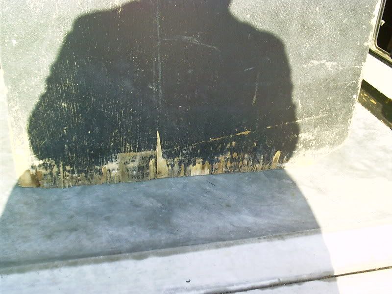

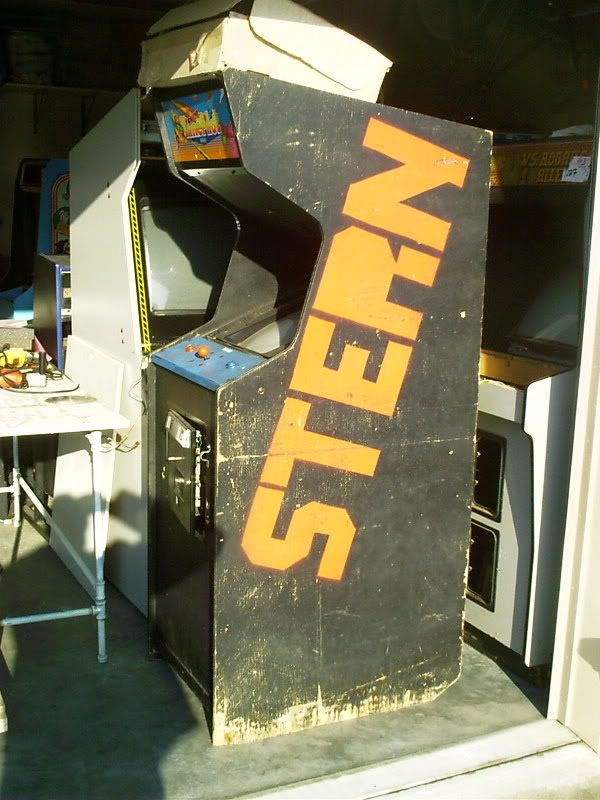

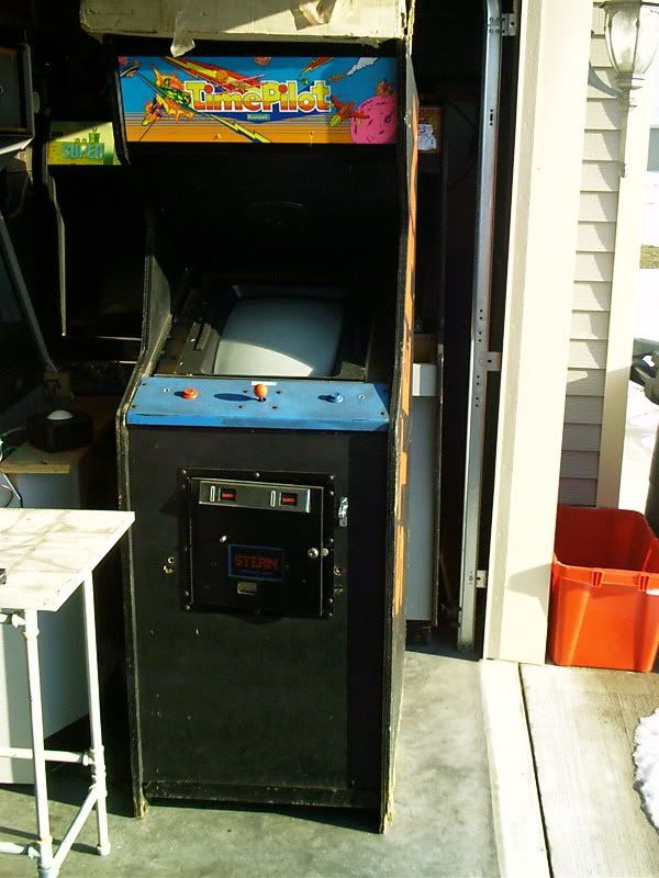

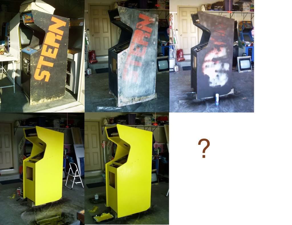

Figured I would post my progress on this one. Started with a beat up Amidar cab that had been converted to Time Pilot:
Paint was worn and faded:
bottom was torn up and peeling/delaminating:

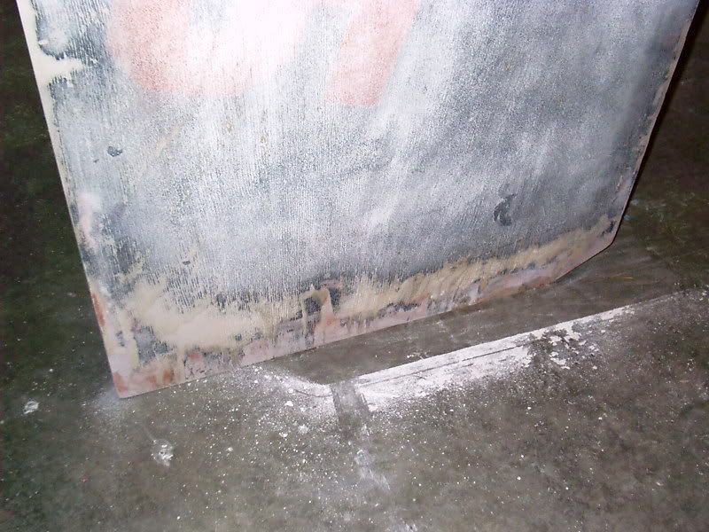

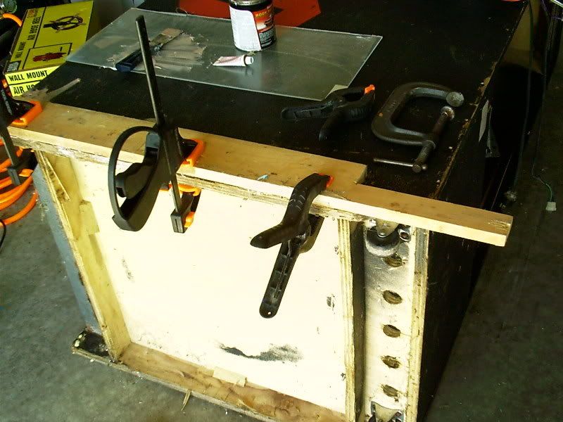

stripped the cab and glued and clamped all loose plywood:

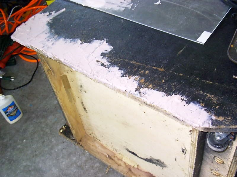

Then mixed up 3 batches of bondo and filled the gaps and gouges:
Sanded her down and top coated with more bondo:
Final sanding:

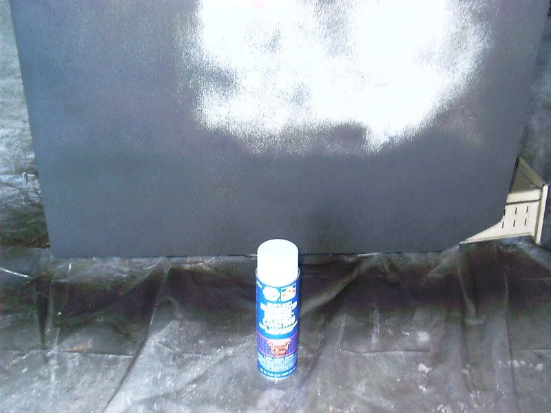

Next I needed to replicate the texture that most Stern cabs have. I thought about oil-based sheet rock texture in a can. I even tried it on part of the cab, but it flaked off too easily:
Then I remembered what the texture reminded me of. Rubberized vehicle undercoating:
Worked like a charm:

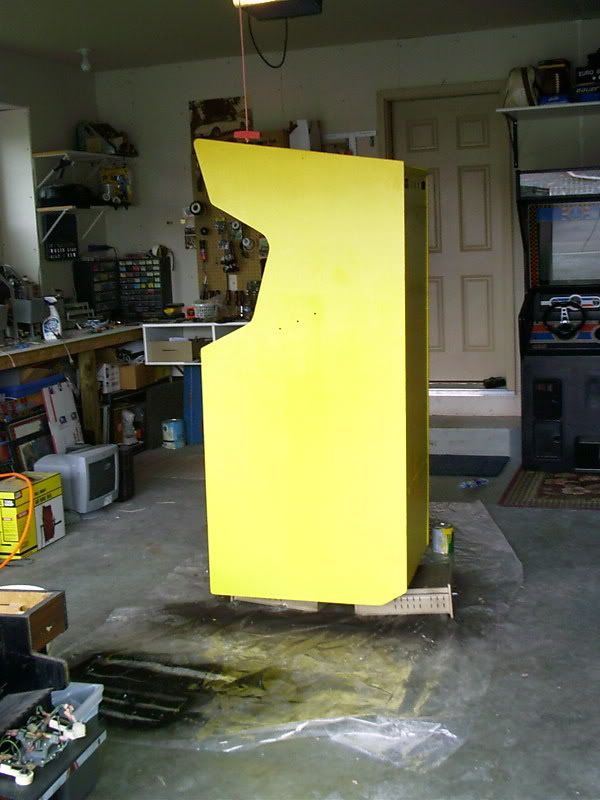

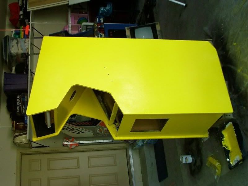

Primed the cab with oil-based zinser (no pic). Then I applied 2.5 coats of John Deere yellow:
I liked the color because:
a. it was oil-based and made for farm equipment (durable)
b. It was a brighter yellow then the scramble cabs (which I find boring and pale.)
c. It will be easy to match for touch ups in the future, as it is not a custom color and right off the shelf.
Here are the progress pics to this point:
