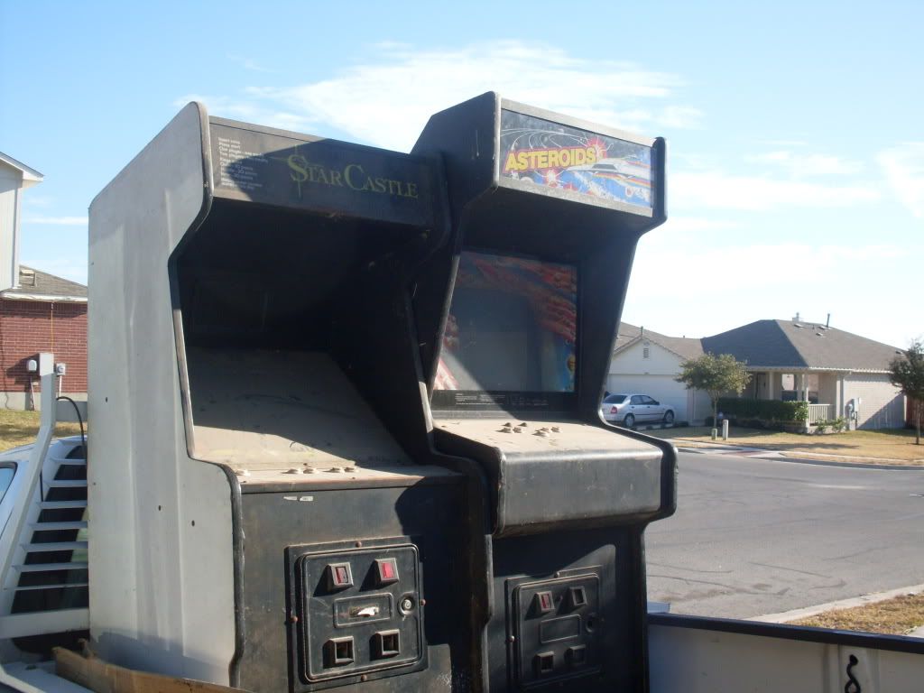

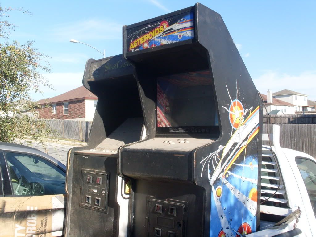

Those in Central Texas probably saw these for the few hours they were up. Don't know if the Super Auction led to the little interest or perhaps the distance, but I snagged these two on Saturday:
More on each in a moment...

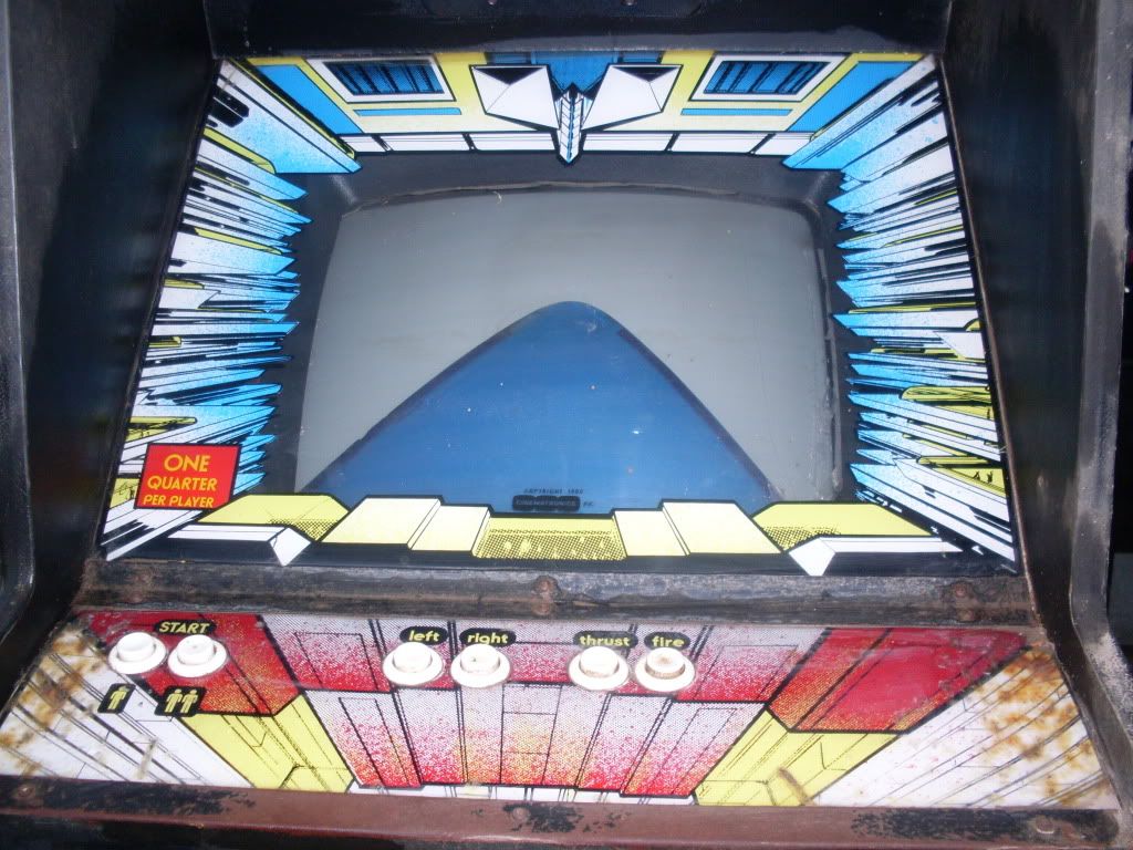

When I got there, both games were sitting in a one wall barn (basically a glorified carport). Apparently a brother died a few years ago, and they found these in an enclosed barn, but moved them to where I found them last week while cleaning it out.

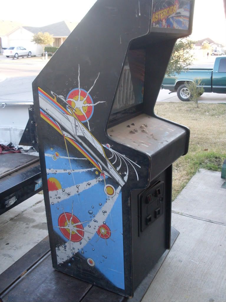

Asteroids (part 1):
Asteroids (part 2):

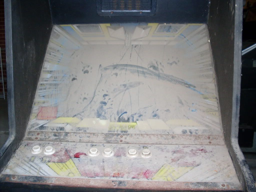

Found 2 mouse nests and 9 mud dauber nests inside. After cleaning it out (thank you shop vac), I did an initial wipedown of the cab (it's a little cleaner now). Not too bad. The mice chewed some holes in the cardboard monitor bezel, so that will have to be replaced. I changed the cord end from a spliced on lamp plug to a good three-prong plug. Looked thru the game for any chewed wires or obvious problems. Replaced two blown fuses on the power brick. Not seeing anything else obvious, I decided to fire it up.
Both start buttons are blinking - indicating board is up and running, but there is no video (spotkiller on) and no sound. Pushing the start button makes it go solid for a bit (as the game plays) then back to blinking (at game over). I check the speaker, speaker wiring, turn up the volume - no sound. I swap in a known good ARI - no sound. Okay - I'll mess with that later. I'm sure the G05-802 needs work, but I just happen to have a working one on the shelf, so I plug it in and get this:
Hmm. Perhaps I didn't get all of that mud dauber nest off of the X/Y section. Oh, well, something to check tomorrow night....
Okay, Star Castle (part 1):

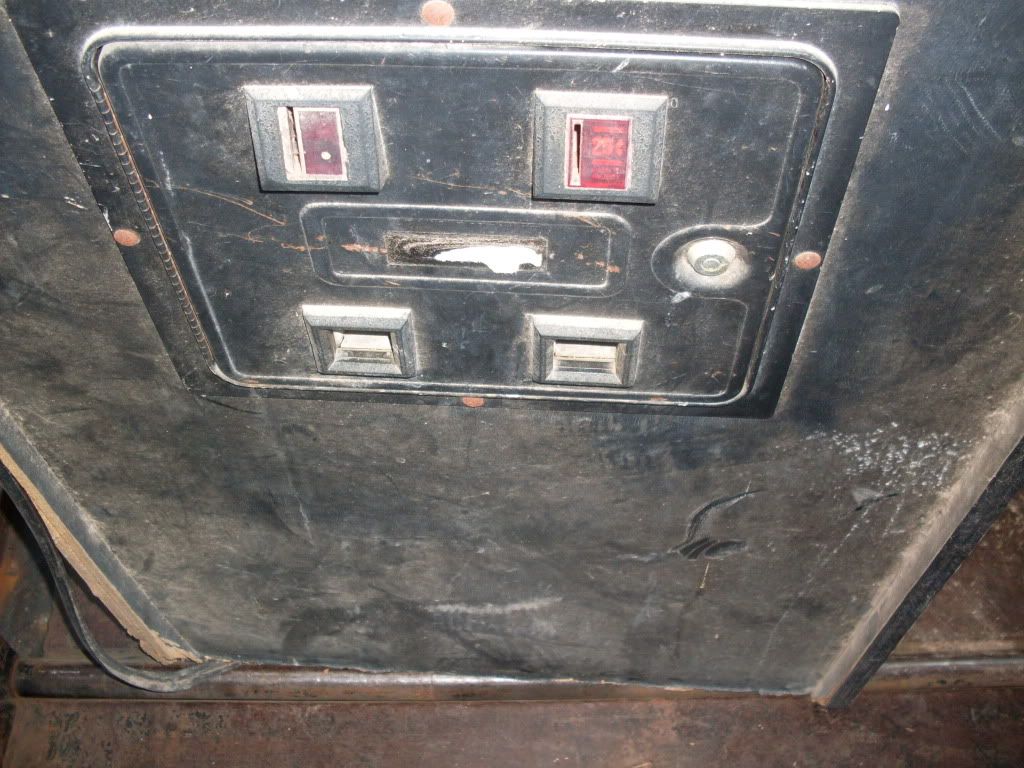

This cabinet has some issues. Back door tried to disintegrate as I dollied it. Top is crumbling, and will need a lot of wood hardener and a little bondo to make right. Bottom front has a little swelling also. Plus, side art is gone on both sides (except for a tiny spot where the tax sticker plexi was screwed on) and the control panel has a lot of cigaretter burns/warp:

Star Castle (part 2):

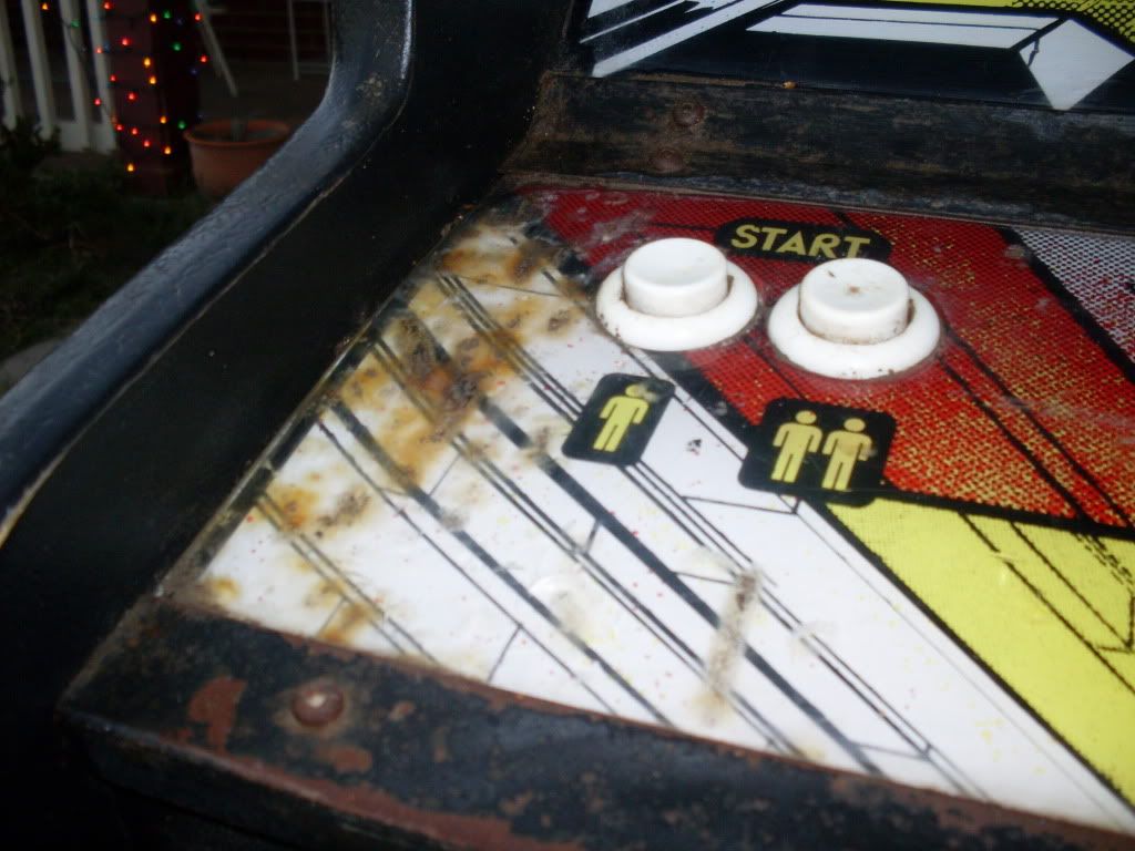

A little cleaned up. Noticed that the colored plexi on the monitor has shifted. You can see the burns on the control panel:
This one only had a couple mud dauber nests inside, and nowhere critical. I looked over everything and didn't see any burn marks on the monitor, the fuse was good, neither of the circuit breakers needed to be reset, so I though i might get lucky - and powered it up. Immediately SPARKS flew from the monitor chassis, and I shut it down. I unplugged the monitor power, then turned it on again, and I have sounds, gameplay, etc. Sounds like the Star Castle boards are working fine, but I have an issue with the monitor now, and probably the power supply (since the monitor has no fuses :rolleyes: :confused: and a bad power supply can blow up the monitor).
