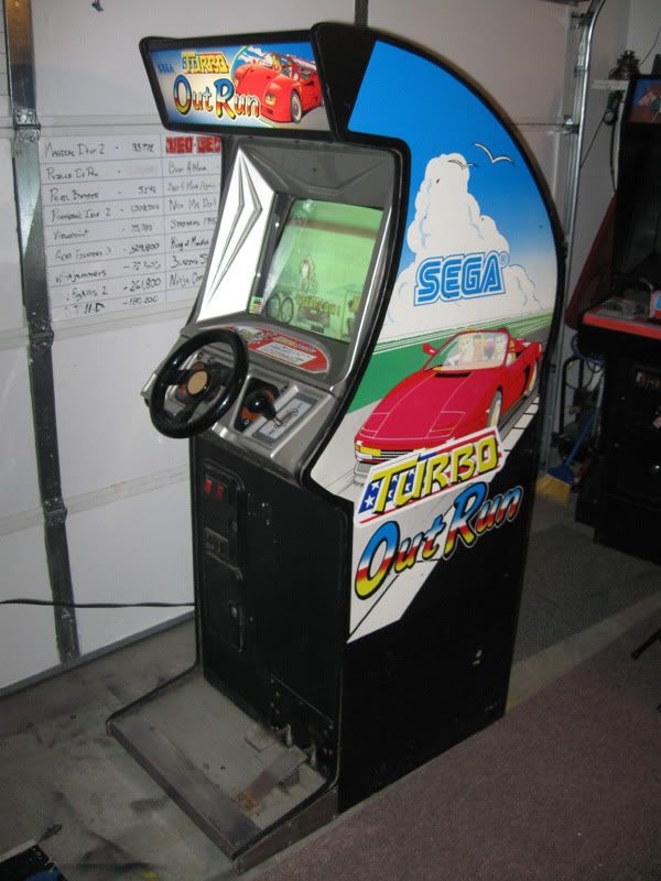

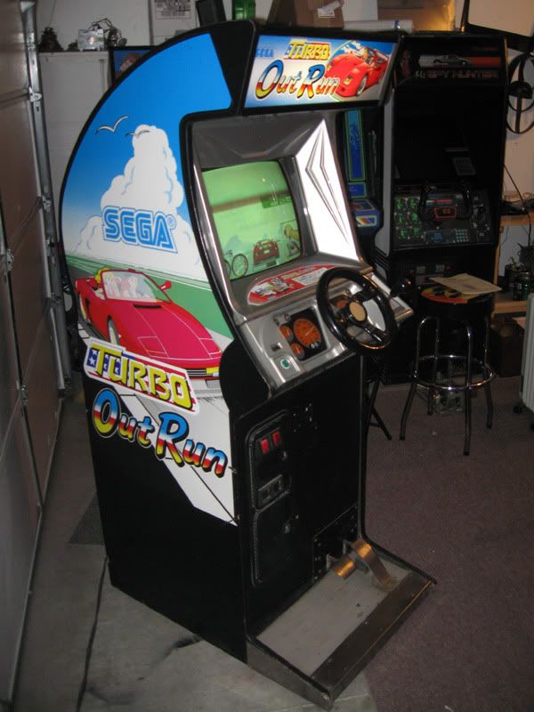

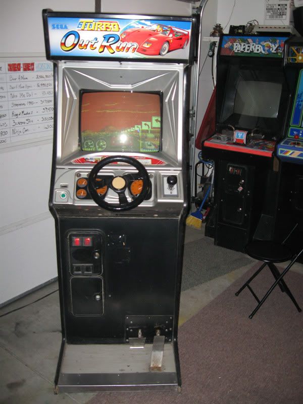

A local collector had this up on CL for a few days... and I was wavering back and forth on whether or not to get it. Evidently I am a bit vocal in my wavering as the wife finally got tired of listening to me and said "Go buy it... Merry Christmas... it's my gift to you."
Can't complain.
Overall the game is in good shape. The monitor has a bit of burn (just enout to be a little distracting...not sure if I am going to get used to it or replace it) and will need to be recapped. It's fully working. Unfortunately it still has the original suicide battery in it. I do plan on upgrading it to the batteryless version. I also am looking for a regular Outrun PCB as well.
First thing I did was turn off the shaker motor. Good idea... asstastic execution.
Anyway... THANK YOU LISA! YOU ROCK!
Nice pick up, there was one on Craiglist locally that i was thinking really hard about buying too! Now, if you need to sell that paperboy to make some room.....

Looks great. And while I'm a bigger fan of the original, ANY Outrun is better than NO Outrun. Its a classic IMO. Worthy of the top 50. And yes, as cool as a shaker motor is, you just can't properly play the thing with it on.

Convert it back to the one and only Original Out Run as soon as you can :)
Take of the Turbo stickers,change the marquee, bezel sticker plus switch pcb and presto you got yourself one of the biggest classic arcade games ever made.
Turbo Outrun boards go for big bucks too, so you could trade or sell that for an Outrun set if you didn't have your heart set on keeping both.
The plan is to keep both...
I will need to buy the non-suicuide kit though as this has the suicide battery.
Glad to see you did it, looks like a very nice conversion. Outrun PCBs seem to go from $180-$200 on the forums (did a quick search yesterday for another member). The Turbo Outrun de-suicide kit runs $40 shipped from Sega Resurrection.
I find Turbo Outrun a lot easier than regular Outrun, you can run into obstacles on the side of the road and not wreck for short periods. Regular Outrun is not as forgiving. Music is better in Outrun and you can't beat it with enough quarters. My nostalgia belongs with Turbo Outrun, but it is nice to have both.
Good job on disconnecting the shaker motor. Prices on replacement gears are not at all cheap.
