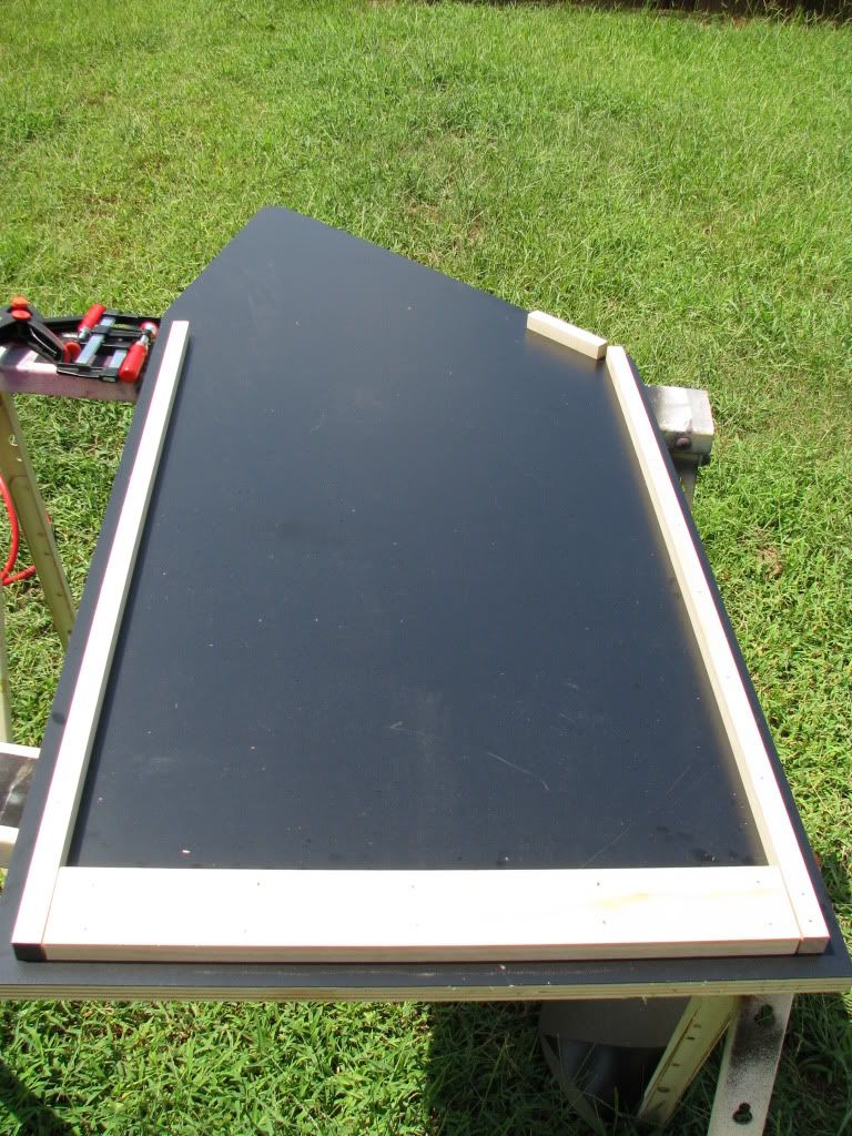

well, the melamine is particle core. Atari used straight particle board, with what i assume to be a heat or pressure (or both) applied film. I can find nothing like it available where i am at. Prok found something he called black film mdf where he's at in florida, and said it's a dead on match to the smooth finish on Galaga. that's also about the same finish on the atari cabs, except for the white sides. Replacement art would fix that. It's alot easier to make new strips to hold it together than sniping off all those staples too.
I think the melamine particle core board looks great, but I worry about the particle board being more susceptible to dings and chips. Doing the cabinet and applying the art is a one shot thing, so I want to make sure. If using birch ply, the only place it would be apparent would be the back (exposed) edges of the side and top panels.
I made these MC cabaret side panels, using matte black Formica on the insides, which is overkill I know, but they're rock solid. With the plywood slightly undersized, they're just right for 3/4 t-molding.

The more I think about it, black adhesive vinyl on particle board would be the closest in terms of available materials and methods, but really, it's not the original cabinet. As much as a replica should be exact, it's still a replica, so it should allow for some very slight changes, as long as it looks fairly authentic and all of the dimensions are exact. I'm not crazy about the melamine particle board, for fear of chipping or dings later. It looks really close to the heat laminated stuff they used, but not exactly. The adhesive vinyl looks closest to me, but due to relying on the adhesive, I'm a bit worried about wear and peeling on the t-molding edges later. Matte black formica of course isn't 'correct', yet looks VERY close to me and has superior wear properties, even if way overdoing it.

Thanks for the advice. I sometimes think, in terms of building or woodworking, there are many ways, then there's a best way. I want to find that best way. I'll finish my Missile Command cabaret rebuild before I start on this, so I should have some more experience by then with laminate vs vinyl.
