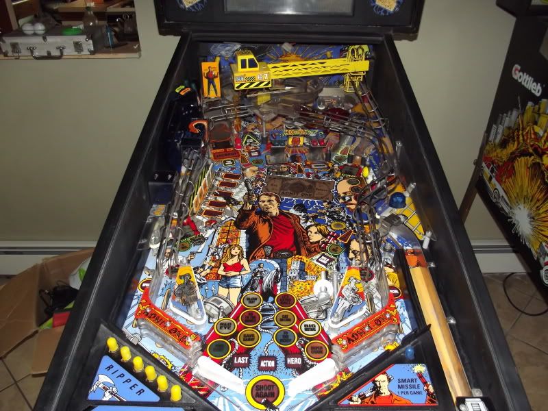

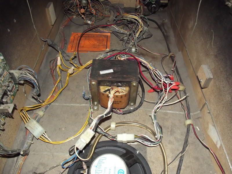

Picked up a semi working Last Action Hero last night. Playfield is in good shape, very little wear, only around the kick out holes so cliffy's should cover that. Very dirty. Wiring is a nightmare, whoever had it last tried to hack in a Williams transformer, I don't know if it was done correctly, so that will be the first part of this I tackle (creating another thread for this). DMD doesn't work, but other than that, everything seems ok. Some sort of after market coin door was put in that I will want to change. Picked it up relatively cheap and I was looking for a project, hopefully this one isn't as annoying as the Mr and Mrs Pacman. We will see.

And yes, the transformer wiring is the scary part. I would like to disconnect and start from scratch with this part, tha'ts even if a Williams transformer can be safely put into a data east machine. If anyone has any info on this, please let me know.

Hmm; any chance it's a re-import? That might explain why the coin door was swapped out, and perhaps why the transformer was as well - may have been set for 220, and somebody plugged it in without changing the configuration? Don't remember if that would smoke the transformer...
Inside definitely dirty, but playfield looks pretty good in that picture.
Bingo!
Plugging 120 into a 220 would mean low voltage - the game wouldn't boot, and the smoke wouldn't come out.
Ways to get the smoke to come out of a transformer:
Short secondary leads together - POOF! (Fast smoke due to pulling infinite power)
Pull too much load through it (similar to above, it gets hot, hotter, hottest, and then smoke.)
Exceed the insulation rating with too much voltage (blows through, the winding shorts, and poof)
Remember, a transformer is a pretty "dumb" part. It takes voltage and reduces it in most cases. So, if my tap is 35 volts at 220 vac, and I drop to 120 vac input, I get around 18 volts. Get it?
