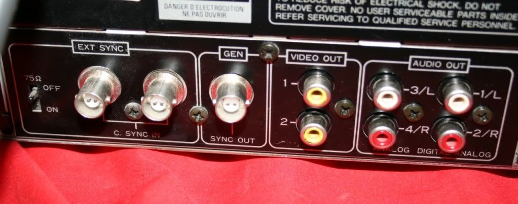

Thanks guys my question is video out. Here is my problem. I have the laserCon hooked up and working on a Pioneer LD-V4400. I just picked up 2 working Pioneer LD-V8000 players. I wanted to use a V8000 instead of the V4400 because its the best player and it has the hold and freeze feature.
I have both LD-V8000's all set up baud rate ect, My problem in video out on the V8000. Do you have to have a special connector? The only video out in the V8000 is a plug connector, not the coax cable connector needed to go to the monitor board. Here is a picture of the back of a V8000 the only out connector that my cable fits on is the sync out and that does not work??? Special connector??

Your NTSC-RGB converter should have a BNC connector on it not a coax. Either way, you can use the video out on that player, all you need is a BNC to RCA. It would be BNC Female to RCA MALE.

Ok might be a BNC I will take a picture of it. Yea the audio cables are RCA they work fine. I will go take a picture of the cable that connects from the special montior PCB to the Laser Player. Where would I find a BNC to RCA connector? Radio Shack?

Thanks Scott this is my first Laser game. I just bought a BNC to RCA adapter at Radio Shack, So I should be able to hook up one of my Pioneer LD-V8000's tonight. Im going to buy the extension cable that tron1969 posted. Im also excited that the Pioneer LD-V8000 has a second video and audio output for RCA cables. Im now im thinking im going to put the laser player on the top back side of the cabinet and velcro a flatscreen monitor on the top front of the machine, hook it up to the extra outputs.

Pioneer LD-V8000 player up and running. Dam this player is fast!!!:cool::cool::cool:
