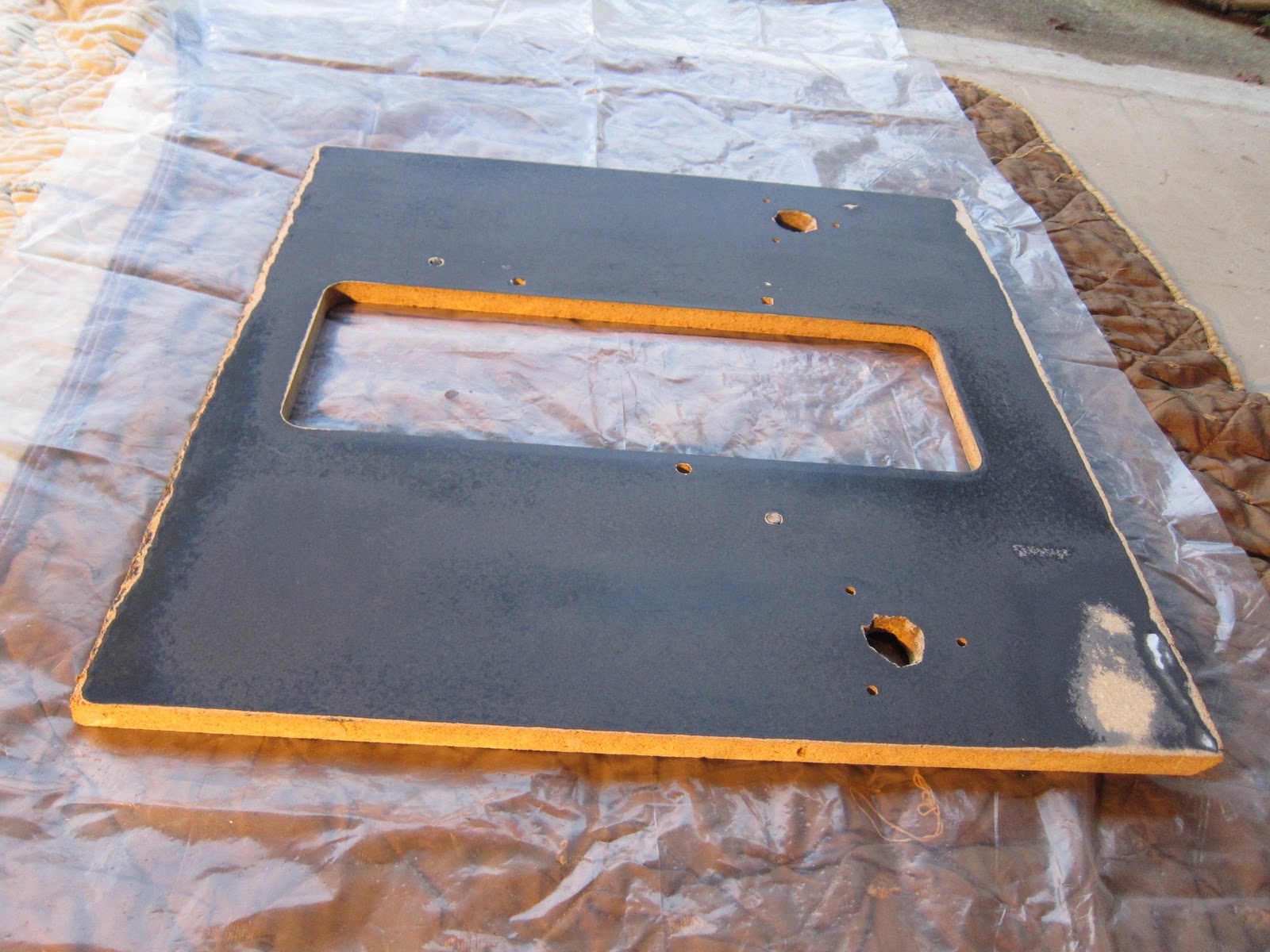

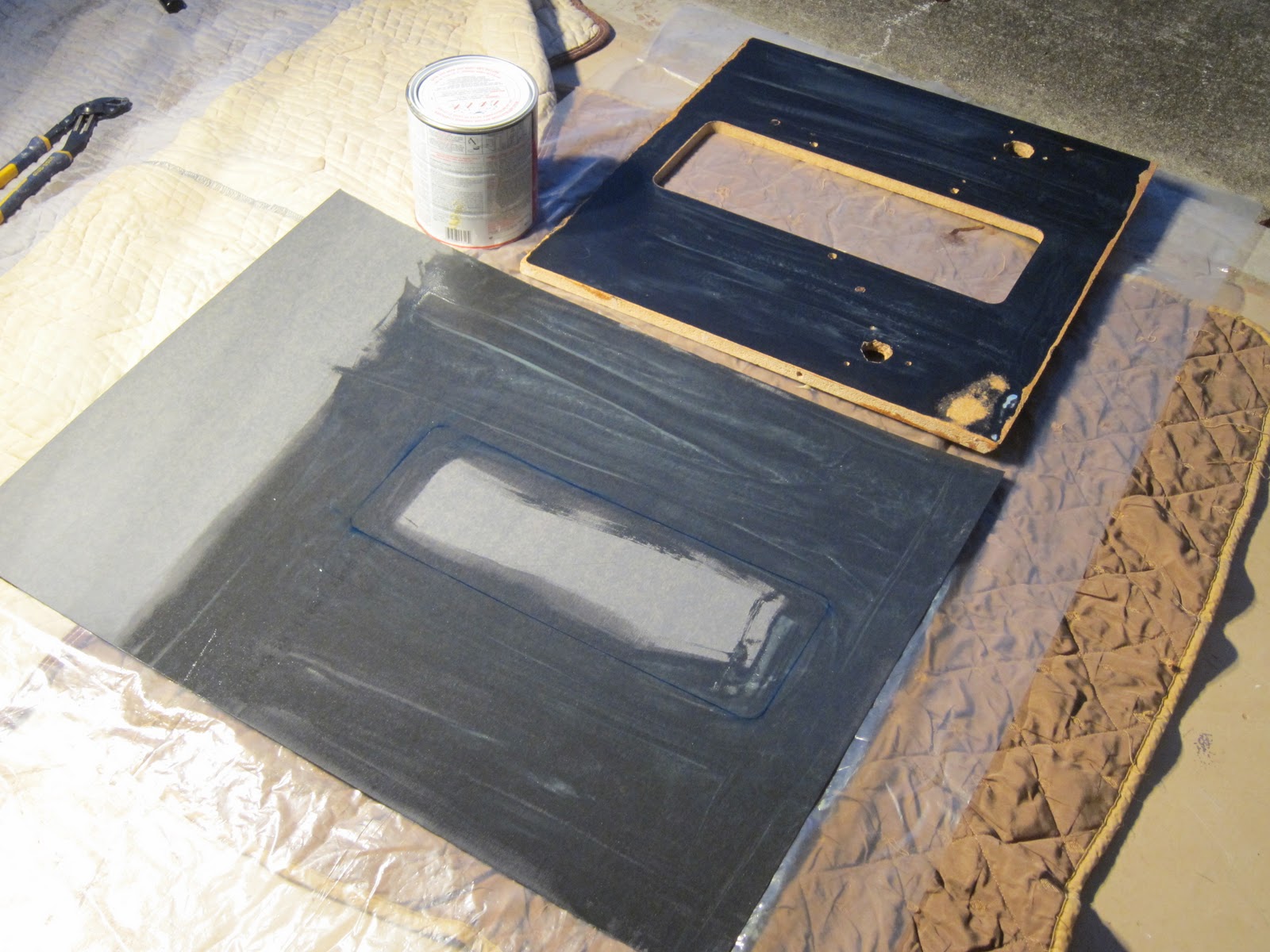

Laminated my first coin door today!

More pics and a blow-by-blow on my blog (see sig)...
Oh yeah, this also shows off my roller-skating table saw. I need to do something safer to make it mobile; that's on the list after all my games are fixed.:)
I see the blog..it came out nice. I found that while the flush trim bit works perfectly well, it's easier, when possible, to get a flush edge, with the piece and laminate oversized, then cut on the tablesaw to get the other edge.
Good tip; I'll definitely do this for new panels. I actually did break off a tiny piece in the corner when I rolled it out, because of overhang. It would be nice to be able to roll it out without worrying about this.
