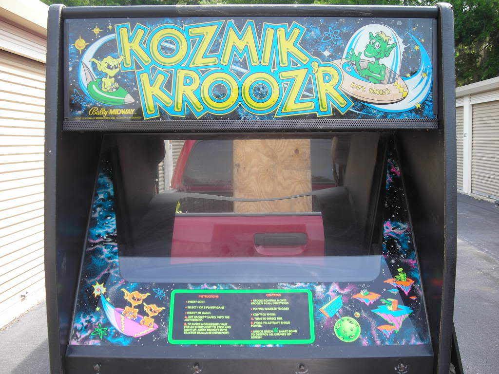

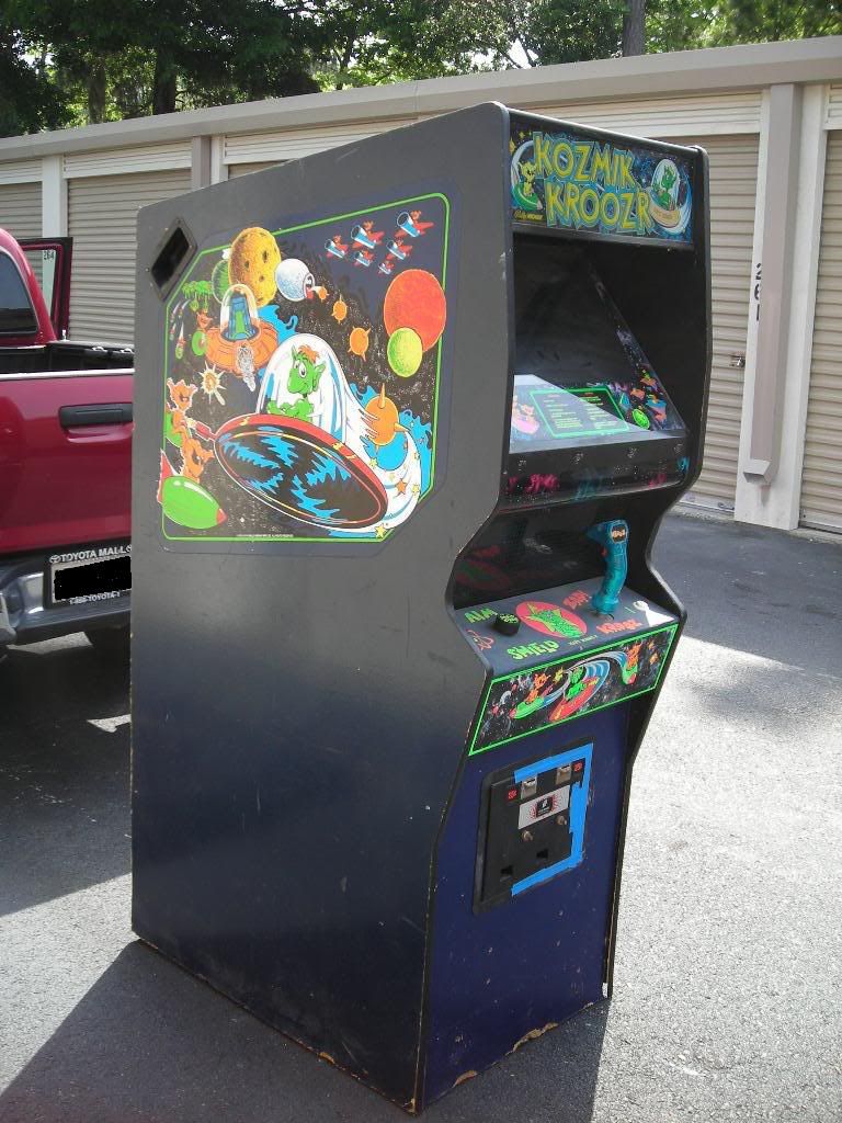

It's not real easy to see what's going on in these pics, but basically there is a 3/4" lip running around the inside of the cab. You can see it best in pic #4. The mirror rests on this lip and there are clamps on the right & left that hold the mirror to it. (Pics 3 & 4) Also the mirror isn't flat. It's molded more like the shape of the monitor tube.
I couldn't get to the front of the game today so all the pics are through the back door. If you think front pics will help I can grab you some, but not today. Also if you want bigger copies of these PM me with your email & I can send the full size ones.
I've never played Wacko, but I always thought it would be cool to have them side by side. Good score there. Hmm... I wonder if the Wacko is as heavy as this. It has to be one of the heaviest games I've ever owned.
Let me know if you need more photos or anything else. Good luck with it!

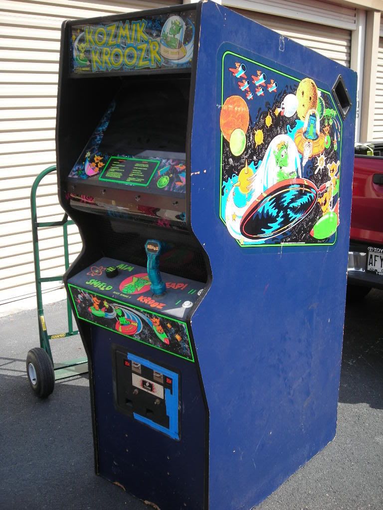

Somehow I ended up with this game here in Colorado and had a friend restore it:
AWESOME pick-up! Do you have the step that goes with it?
