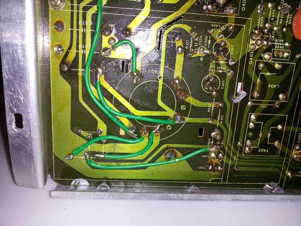

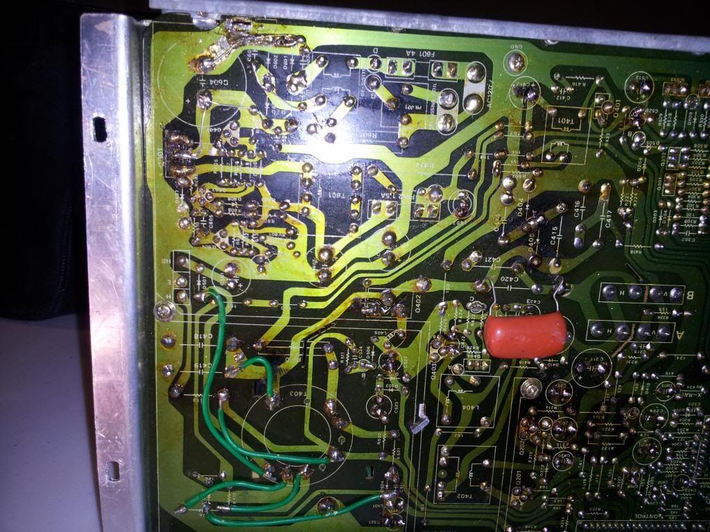

I pulled the chassis, and this is the underside.
Like I said, I have not had a lot of issues, but this is crazy. Is this worth messing with? I repair around the main cap in the first pic scares me the most. Thoughts?
seems kind of strange why it is like that.
i do not repair theses chassis types.
but it seems like at one time it was cracked or when the fly was replaced they may have ripped up the pads and needed to run jumpers.
to me Kortek is junk but if it is the only monitor you have then go for it.
good luck on the repair.
Peace
Buffett
Ya, it is crazy. The only issue is waiving, but is it worth replacing the main cap do you think, or could it be because of the crazy repair job that power is bleeding through somewhere causing it?

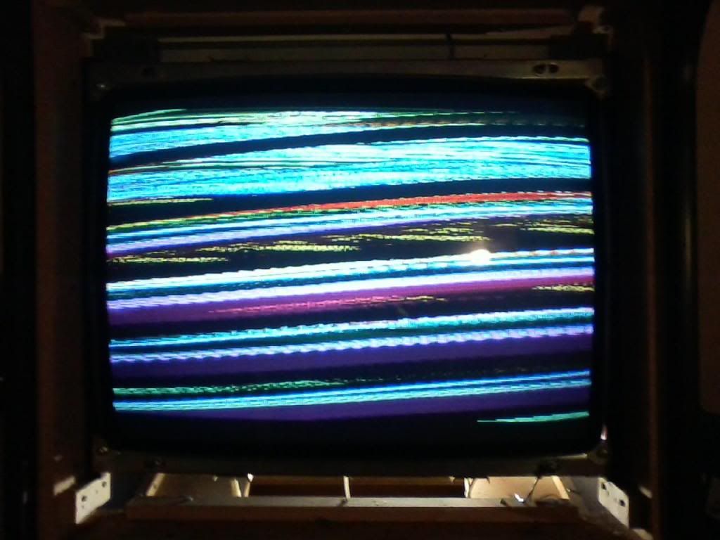

Alright. I got a new main cap from Bob Roberts and installed it today. That is all I touched and now I get this.
Not sure of what i could have messed up. Any ideas, or is this one not worth the hassle?
I farted with H-Hold a bunch and could not get it any better. I will try again tonight.
you may need to re-flow the video input headers and verify that your sync is properly connected.
also verify that the video wires are good from the PCB to the monitor.
Peace
Buffett
I went back and turned the H-Hold again and screen went out completely this time. Now I get nothing.
