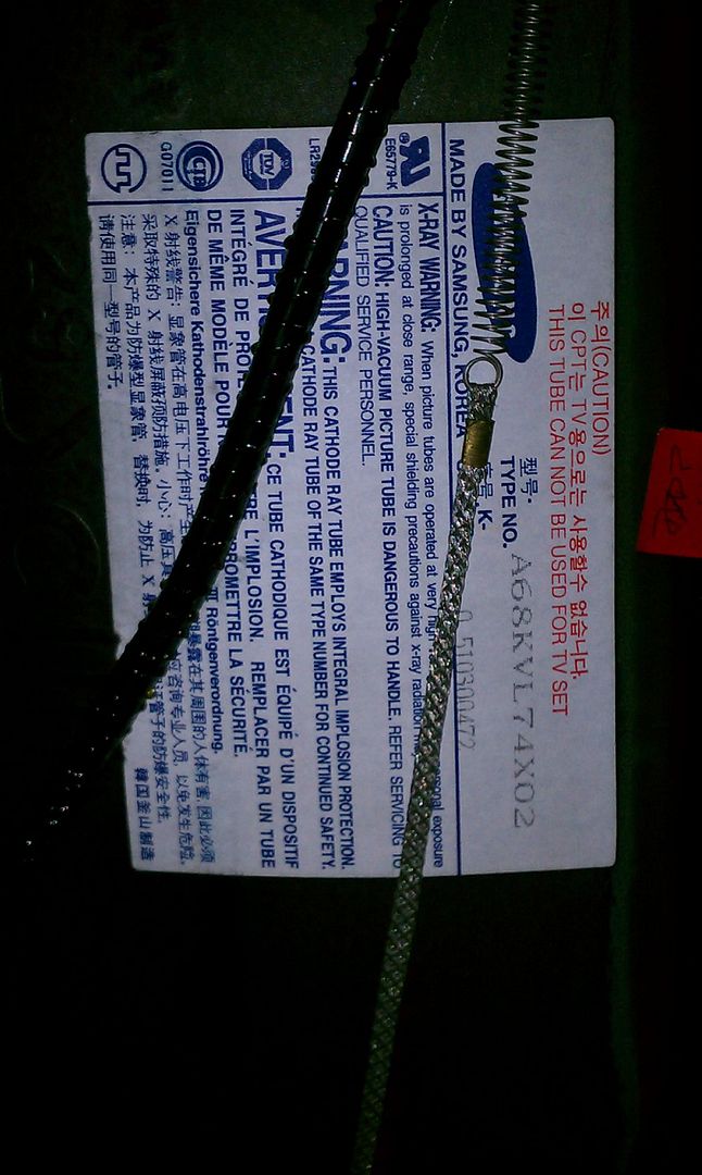

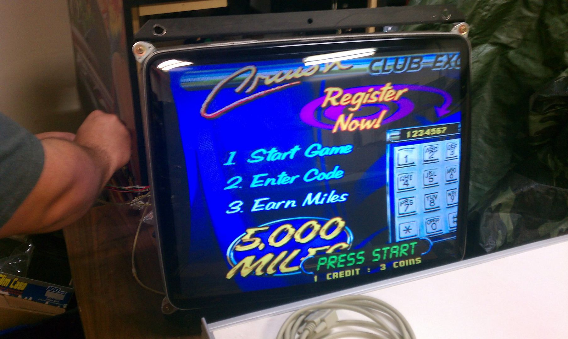

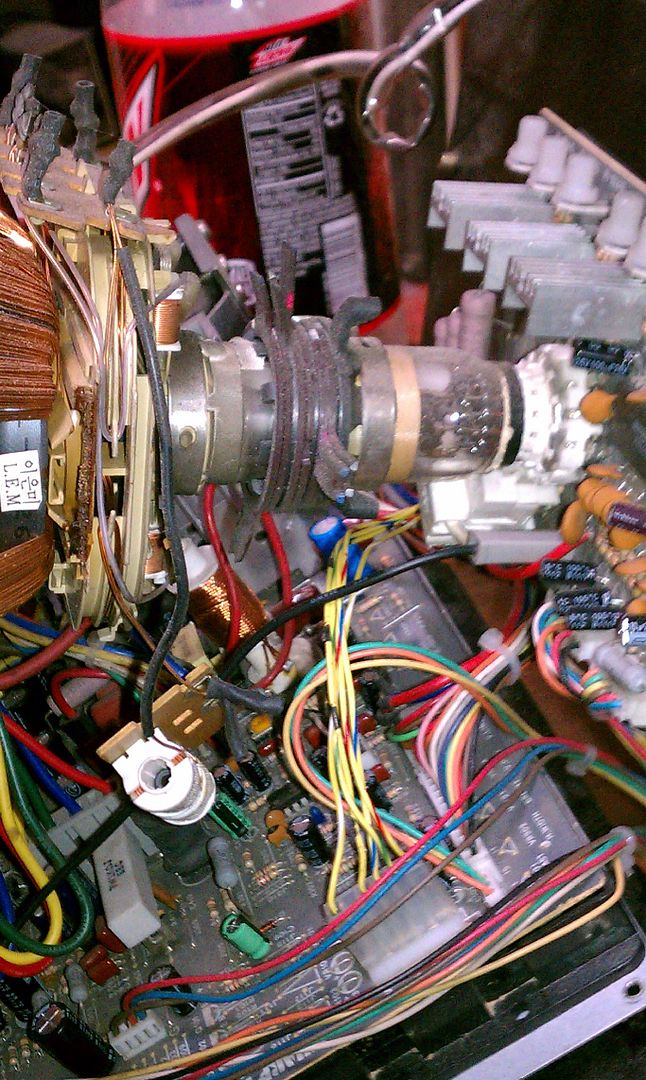

So the continuation of the monitor situation... We swapped out the PCB and recapped it; however it appears this is for a larger monitor? I am informed it may be a couple of capacitors we have to change to give it the correct scan specification for the resolution. Any help is appreciated!

Hey, thanks. I contacted them and bought a cap-kit, but it didn't solve the issue on that PCB. One of the high load transistors near the flyback heats up (which I replaced the burnt out one) and creates a high pitched whine. So we managed to get two other Sharper Image boards and see the above post on the situation there.
Anybody have any hints at how to correct this, or with what values? It's a stretch, but we're trying to work with this board since it appears to be fully operational and just needs to be reconfigured for this monitor neck and tube.
Caveat: I'm not familiar with Sharp Image chassis, so take this with a grain of salt.
Since it's vertically almost perfect, I doubt it. I see the adjustment pot spots aren't populated, which means there should be a remote board. The monitor should have a small board at the end of a fairly long bunch of wires (or sometimes a ribbon cable) populated with a number of pots -- you should be able to dial that picture in with those. If the board is missing, you're in trouble...

After playing with the picture adjustment board this is the best it gets. The fellow who gave us the board informed us it goes to a larger tube and might need some caps replaced to alter the scan values for the right setting. I am not sure how the capacitive values alter the picture in such a way, but I will continue to try researching this!
