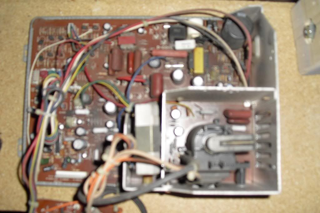

I want to clarify something that I am confused on. The Kortek K1-2-VO chassis.
I have 7 of these monitors. All are 25". I am specifying this because there are several threads on here that refer to this chassis as a 19" and I am not sure if they made them 19" chassis as well, or if that is a mistake. I want to do capkits on all of them. Moddesitt says in this thread……….
http://forums.arcade-museum.com/showthread.php?t=120064&highlight=kt-2001sf
………………….that the K1-2-VO and KT-2001sf are one in the same. However, Bob Roberts' Monitor ID page has the K1-2-VO as the KTA-915.
http://homearcade.org/BBBB/kortek.html
What are your thoughts?
Thanks in advance.
-Kyros

I also say in some other thread that K1-2-V0 is now recognized as a generic marking for several different Kortek models, and is not indicative of the actual model you have.
If you don't know for sure, post pics of your chassis and we'll see what we can determine...
Right on. I did not come across that post during my search but it being a generic marking makes things much clearer now. Here is a picture of one of my chassis.
Edit: I bet it was this one?
http://forums.arcade-museum.com/showthread.php?t=166630&highlight=ktx-26
Sorry for the poor quality. Thanks for the help guys.
