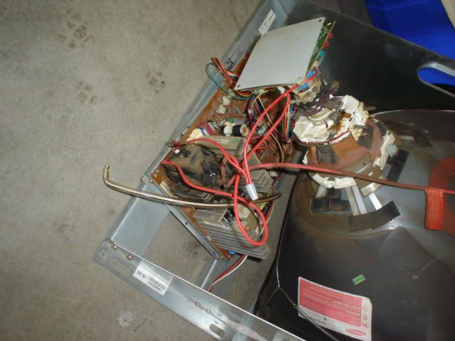

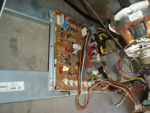

guess ill ask about the one i just replaced
got a street smarts (cut corner dynamo 19 inch cab)that had a 19 inch kortek in it

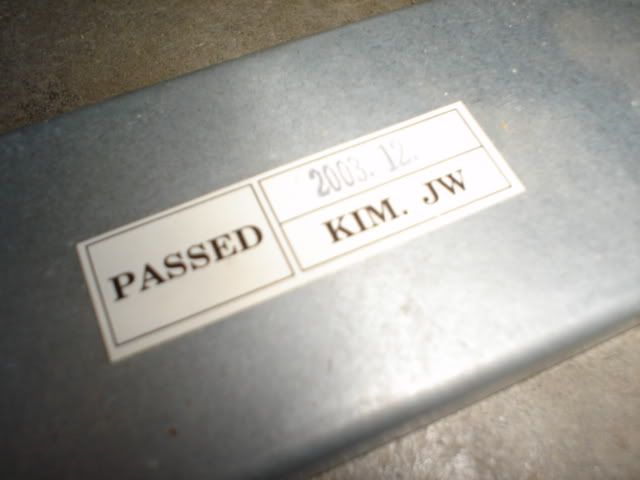

the monitor has a build date sticker of 2003 on it am i correct to assum that this is an imperial (and can use the manual from mikesarcade)
it has a beutaful samsung tube on it so i have been messing with getting it going again
im getting no neck glow (meterd the wires in teh street smarts and get 120 v and the eyego i installed to replace the kortek works just fine in the machine)
i have meterd the fuse and its reading 0.1-0.3 ohms so its good
inspected the chassis dont see any visible bad caps , everything looks intact excp this wire coming from underneath the flyback going to the neckboard has been hacked
where should i go from here
thanks in advance
