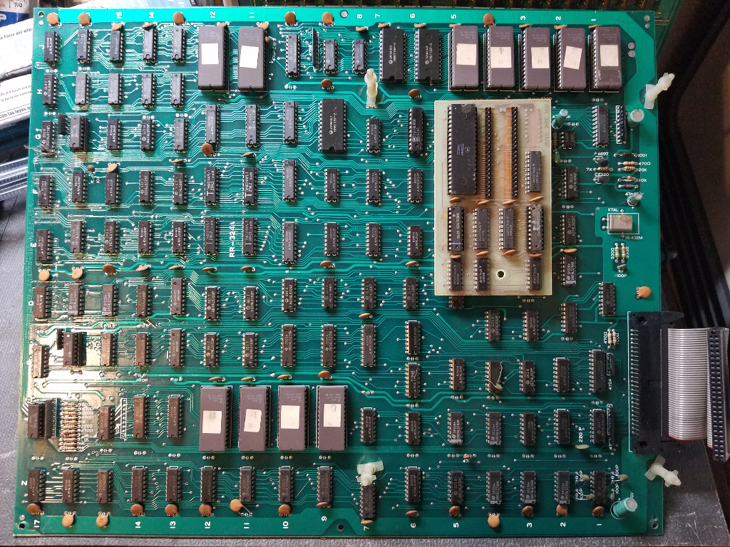

So... These are the 2 pcb's that make the RnR boardset (including a smaller sub-pcb):
The top pcb looks 100% legit, and has a serial sticker of RR-008 on it (LOW!?)
The bottom pcb does NOT have the KONAMI name anywhere on it (which it should?) and the sub-pcb seems legit enough...
Can anyone offer advice on this?
Legit boards will have a "Kosuka" sticker near the edge connector with a serial number on it. Bottom board will have Konami silk-screened on it (with the KT-whatever board number).
Man those bootleggers sure deserve some credit for being so damn crafty back in the day. There was a HUGE sub industry here in Canada. I met an operator that used to import 4-500 pcbs at a time from the bootleggers, and he was just one of the guys.

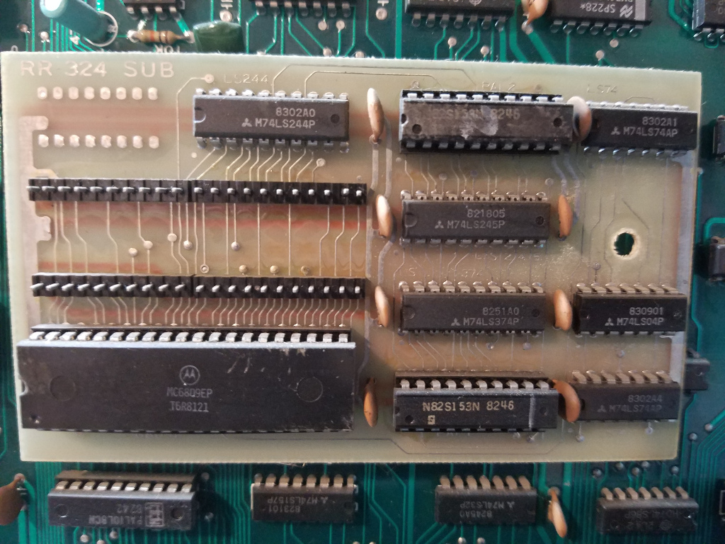

yeah and i figured out that the sub-pcb (RR-324 SUB) is what replaces Konami's encrypted/custom IC at F/G 4
and like CosackWarrior said, these reverse engineers must have been amazing with mad assembler/c++ skills to do this. and build a new pcb on top of it all! they need credit!!!!
