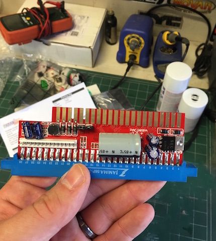

I received the latest version 2.0 adapter Kngcbra which you can see here -
It's very well made and very compact. The fitment on the fingerboard to the Pac Harness is very tight and solid. You'll noticed there is a header there to allow for custom panels which allows support for additional P1 & P2 Buttons and ground if you have the need.
There is also jumpers for the Stock Button Assignments which you can turn on and off. By default, P1 Start ---> P1 Button 1 and P2 Start ---> P2 Button 2

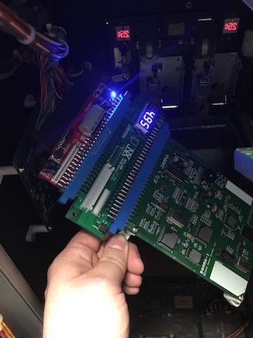

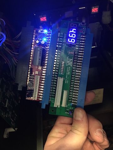

Here is the adapter installed on the harness, I'm using a JNX Atlas adapter in this picture only for visual representation to show the +5v voltage output which you can see is essentially on the nose.
And here you can see the voltage under load with a multiboard attached
