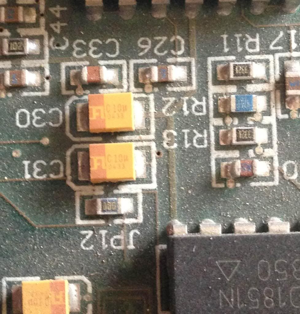

I've got a KI board with a blown C30. The manual doesn't show the pcb parts. Does anyone know what value it should be? thanks!
Thank you!... these are tantalum caps right? can you use other type of cap?.... also how do you read them? I see the C 10u 04 33, and the only one I get is 10u..
I Have a broken midway pcb, with the same size cap with the value as c 10u 9733, are the last 4 digits the man date? or is it related to the specs?
you can use any radial cap even non surface mounted ones, just looks nicer if you do.
the 9733 is a man date so it doesnt tell you squat . I am only assuming the voltage is 16V since ALL of the caps that are large enough to have the voltage printed on them on that board are 16V, you can use any Voltage value as long as it equal to or greater then the original value so a 25V cap would also work, but if you get one thats too large of a value it may be too large to fit on the board or pads.
