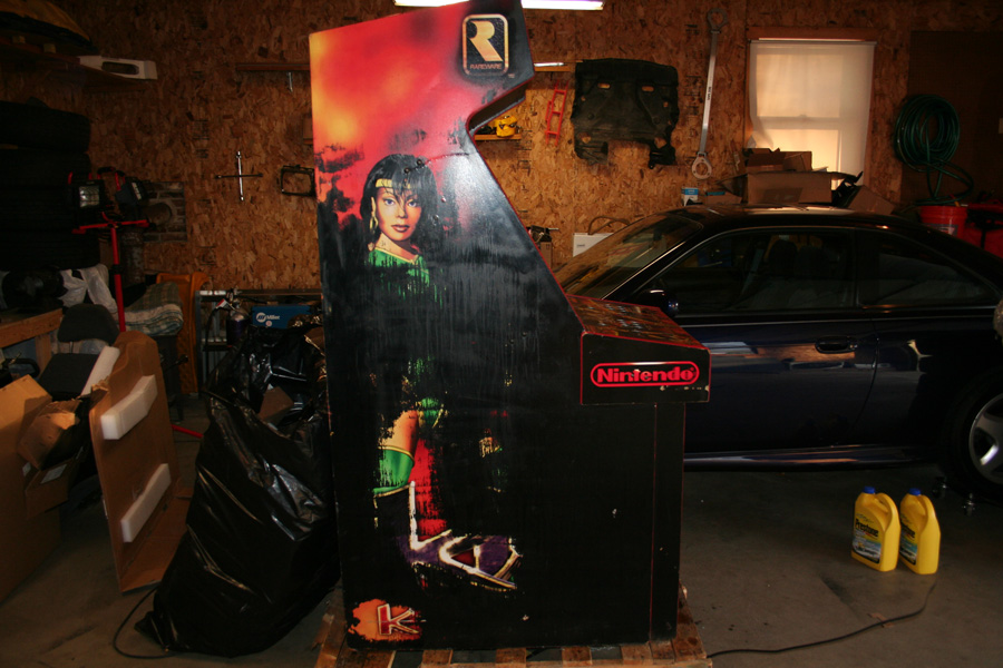

This is what I started with: it "was" a KI2 machine but it had been converted to "Turkey Hunter USA" at some point and then decommissioned and had the light gun and PCB pulled.
Some of the paint had been removed from one side of the machine, I think the seller wanted to show that it was in-fact originally a KI2 machine

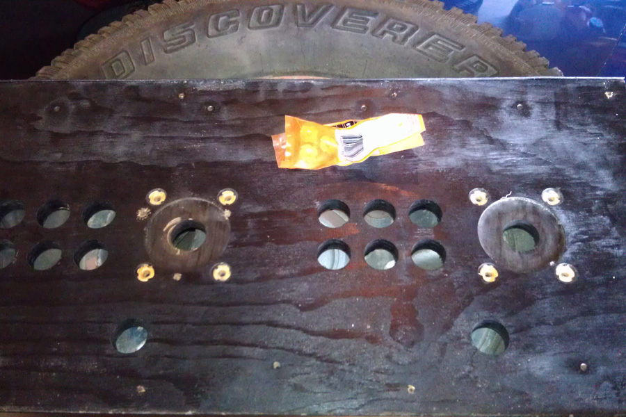

the holes drilled into the CP for the turkey hunter conversion make me sad
it looks like I at least have the original button holes available which is always good
Looking up close it appears that you can see the original KI2 control panel graphics under the camo... which seems promising.

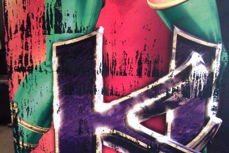

The first order of business was seeing if I could get the paint off of the side art. I did a quick search and found people suggesting "Lift Off" as a good paint remover that wont damage the graphics. So I picked up one and tested a small spot on the bottom corner. It seemed to work so I sprayed a slight larger section and I was pretty happy with the results
after about 2 hours of scrubbing and dousing I really didn't get too far, I managed to get all of the paint off of the front and side of the control panel box along with about the top 5th of one side of the machine
I had to stop because my hands were killing me, the stuff works but it require a ton of elbow grease, I tried using a buffing wheel on a drill in a small spot thinking it would be non-abrasive and wouldn't kill my hands but: too little pressure woudn't do anything and too much pressure burned right through to bare wood (thankfully I picked a small corner near the back to test first)...

Using a slightly more powerful variant of Lift Off, and a plastic paint-scraper I was able to make short order of the rest of the side paint... it still took a few hours but... yeah, it looks great.

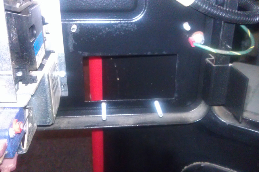

I also noticed there's a panel missing from the coin door, presumably there was a bill collector installed at one point. If anyone knows where I can get a plate for that hole, I'd be grateful :)

Nice progress. Try citristrip on side 2

also thanks for the tip on citristrip, I'll see if I can find some for the other side. Do you know where it's carried?
I've also heard that 3M safestrip works well but I was unable to find it for sale anywhere.

I've heard good things about the safestrip as well, but the citristrip has done me right a few times now.

The Lift Off worked better once I got the hang of it. You really need to spray it on HEAVY then go do something else for 20 minutes and let it set in... I was having the same problem as you where the dark areas didn't want to let go of the paint.
Some one on another forum recommended laying the cabinet on it's side when using the paint stripper. I think this is a good idea because it will let the stripper set in evenly, I had the problem where it would come off only where the streaks had been created leaving me with this:
then I'd have to do a 2nd or 3rd round of the stripper to get the rest of it.

Srsly though try citristrip gel. honest, just try it. The paint just sloughs off. It's freaking unbelievable. I'll never strip a painted cab with anything else now. Brush it on, let it sit for a few minutes, then take your plastic putty wedge to it and watch it melt away.
Yeah I picked up a bottle of it last night, I probably wont get a chance to work on this again until the weekend so We'll see how it goes.

I got the second side stripped over the weekend using citristrip... WOW that stuff works about 100X better than lift-off, I feel like a fool for wasting so much time with that other stuff on the first go-round.
I'm thinking Lift-Off might be more useful if there are more delicate original graphics, but for vinyl graphics citristrip is without a doubt the way to go.
I got a few other things done this weekend too but I spend a day, disassembling the Virtual On Twin unit I bought a little while ago and getting a bunch of people together to help me move that as well as KI2 into my basement.
I'll be starting a resto log on VO soon, not much needs to be done with that as it's complete and fully working, so I'm mostly just cleaning it up...
I'll post pics tonight or tomorrow once I pull them off my camera.
Nice warm weekend so I was able to get out to the garage and finish up the paint stripping. I tried Citristrip on the 2nd side... WAY better product for this than Lift Off... Lift off might be nice on more delicate paint but for vinyl graphics Citristrip is the way to go.
Before:
After:
Basically "painted" it on, waited half an hour, glopped off 95% of the paint with the scrapper, added more stripper to a few remaining spots, waiting another half hour and took those off... then a couple rounds with simple green to get off any remaining residue and Roberts your father's brother.

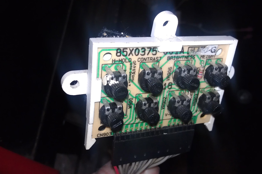

Now that I had a good PSU I could test to see how many of the electrical problems cleared up... the answer... pretty much all of them, but the H Hold on the monitor was all jacked up.
https://www.youtube.com/watch?v=lHxTnAhAsqw
playing around with the knob on the adjustment board fixed the h-hold... although it was super sensitive, and based on the fact that the h-hold was marked with white out, and the adjustment board was mounted with velcro for easy access, I'm guessing this machine has had some monitor issues.
once h-hold was fixed the image was blurry a little dim and the size/position was a bit off too... most of the adjustment pots were either super sensitive or where all the way at one end or the other of the adjustment range and needed to go further. I'm hoping the capkit and new flyback should clear that up.
One of the coin mechs on this machine was missing, and the other one was broken, I had some spare parts so I fixed them up... not that I'll ever need to use them but I feel better knowing they work :p
Unfortunately this machine used to have a bill validator so now I've got a nice square hole in my coin door, I've been unable to find a block off plate for it, I'd be happy if I could get a validator (even a broken one) to fill the hole and make it look less messy.

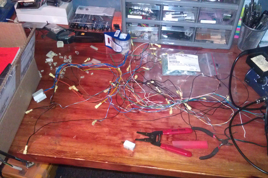

I started looking at the control panel wiring as well, this is what I've got to work with:
the previous owner tossed 2 of the 3 harnesses and the 3rd harness had all but 2 wires snipped... I found a NOS gauntlet legends control panel harness for $15 on eBay so I bought it since it has all the connectors I need. I started stripping it down and realized that it wasn't going to work out as is.
I'll be able to use the 12-pin connectors and have all the proper color-matching wires but I'm going to need to crimp my own quick disconnects. This will probably work out better anyway since I can control the length and make everything look OEM

I disassembled the control panel and discovered that the Tee Nuts for the joysticks had been removed (why, I have no idea). I needed some other hardware anyway so I picked up some new Tee nuts and got those installed
I disassembled the Gauntlet legends harness I bought and repinned 3 of the connectors to match what the original KI2 harness should have been. My fingers are killing me but now the control panel harness uses all of the proper original style connectors and wire colors.
I got the control panel reinstalled and the newly built from scratch harness crimped and installed.
