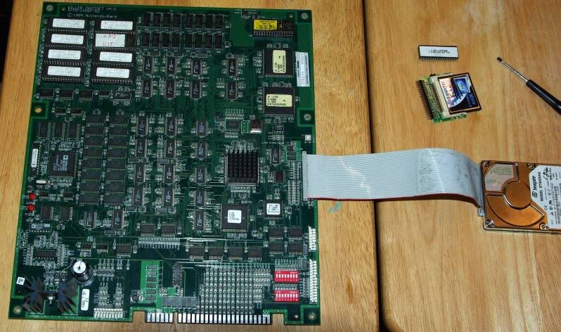

ok so i got a ki2 board and hd from ebay it comes up with a rolling blue screen i reset all the chips still got the blue screen so i got a cf card conversion and boot rom and i am still getting the blue screen any help would be great

there's a red LED on the board for disk activity, does that light up at all? (your CF should have one too)
getting good +5V?

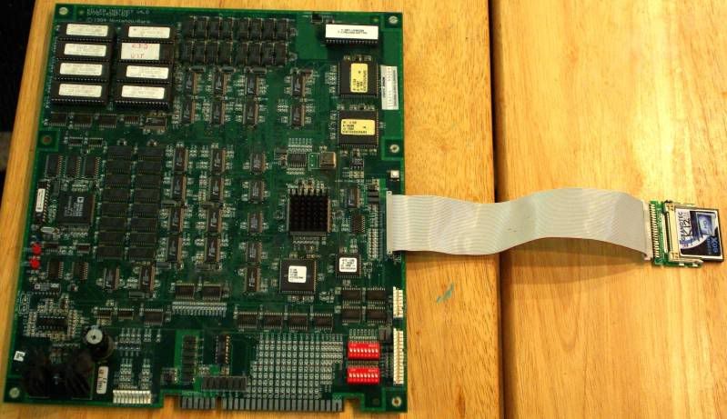

ok here are the pics

First, make sure the chip in this picture is labeled KI2. If its not, you have a KI 1 board trying to run KI 2 without the HD interface adapter.
Verify your +5
Make sure the eprom select jumper is set to 4meg roms. I bought an ebay board once and it was missing the jumper...thats all that was wrong with the board.
When you added the cf card did you reuse the original cable? If so, possible bad cable. I always use the cf adapters that plug directly into the board and eliminate the cable.
Other common problems are bad processor, and surface mount components needing to be reflowed.
Try pressing on various chips and applying some pressure while reseting the board each time, sometimes its just a loose chip.
I heard that the processors can break loose a few legs to create similar problems.
start by reflowing the CPU.
there's some other "Altera" surface mount chips on there too, try inspecting the legs on all surface mount chips with a magnifying glass.
