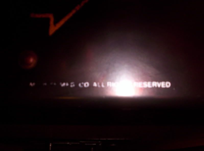

Looking at the 2 I have I now see the remnants of what looks to be a trademark text at the bottom of the pannel.
Yeah I almost didnt catch that untill looking over Spydrons resto blog.
getting a complete scan of that on a panel is going to be slim to none
but luckily the same text is on both the marquee and bezel
so Ill be able to match it to that and got the scan of the marquee from JoyMonkeys site.
will need to reshoot the screen but not that big of a deal to add.
