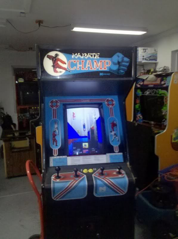

I just picked up a dead Karate Champ. After a couple of quick fuse checks I found one to be bad so I replaced it. The Marquee lights up and the game plays blind. I checked the monitor which is a WG 19 K4900 there is no glow in the neck board, the fuse on the board tested good and I checked to make sure power was a go as well. I tred reseating the neck board and still no glow and no monitor. Any ideas? Thank you for your time and talents.

checked it today... replaced the fuse and touched up some cold solder...
guess what?? CATASTROPHIC FAILURE!!
we were also to check out a g07 and a power supply while jason was here.. thanks for makign the trip dude, see ya soon to work on your car :D
flyback arcs sparks and makes hellatious smoke.
so it DOES need a flyback :D

whatever you have to tell yourself mod :D i knew we were hosed when i looked at the ferrite part and it was all cracked.... it makes a hell of a bizzing arcing smokeshow... real neat to watch but couldnt leave it powered too long cuz we didnt want to smoke the hot and such.. I really like those 4900s.. nice and simple, well laid out...

Well here's a pic of it with the working 19K4900 I picked up from mike.
I need to switch the yoke around so the picture is right side up. lol Then I'll do a cap kit to get rid of that streaking unless that just an adjustment?
turn down the gains and cutoffs itll go away but like i said its so touchy that i guarantee itll need caps..
