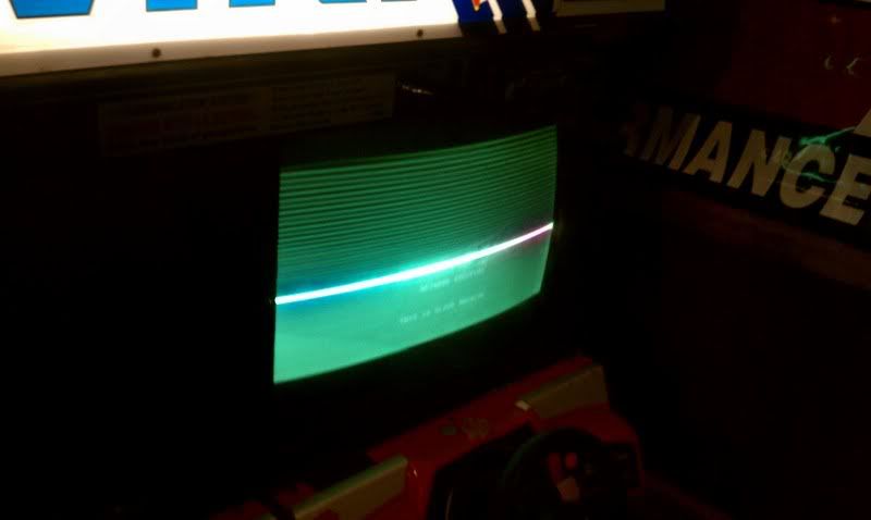

k7500 wells garner picture attached help please
U601
Tda1771 Vertical Ic
along with a cap kit or need
to replace the caps in the 600 block and c305 next to fly.
Most of can tell by the reflowed solder if
the chassis has already got a cap kit,if not
should replace all the caps in chassis
verticle deflection
start with the electrolytic caps around the vert. ic. on right side of board connected to heat sink.
Then ic, diode connected to vert. ic, possible that zener diode next to flyback is going out that feed voltage to vert. ic.
