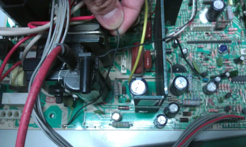

I was just messing around on google last night and discovered that if you don't wrap that one wire around the core of the flyback correctly, you lose half the screen. why nobody here mentioned that, whatever. :)
I got it to work. tube's installed on the K7500 frame and all. the blue pot went a little flaky, and the joystick board isn't working right, so I can't get it to a crosshatch pattern to do some more convergence work, though I'm probably 98% there, hard as the rings were to turn, I somehow turned them a little bit, and I'm afraid to get too aggressive with them or else I'll break them.. so I might just leave it.

can you show a pic of what wire you put around the flyback in case somebody else has the same problem.
So, all you did was wrap that wire around the flyback ?

I put the monitor back in the cab for now but have to pull it to fix the blue bias pot, I'll grab a pic then.
notice the part I'm holding up, that goes over the wired end that connects below the flyback. I'm not sure if that makes a difference, but considering this stupid wire makes any difference at all, it might lol (got this from an extra parts chassis that still had the original ziptie around that wire I cut off so I could show the placement better)
The black wire on k7500s is always looped around the core (flyback). Issues I've had with that wire is when I replaced the fly.. I kept the wire in the same place it was originally but half the screen was missing or dark bar.. What I finally figured out was to not solder one end down and use an alligator clip.. Loop it in different ways till you get a perfect pic.. Man, what a pain in the ass to figure out on your own.. The WG flow chart points out this wire also..
i would put the wire tie back on so that it does not move around and makes the turn that is required for the image to look rite.

I wish someone could explain this wire's significance heh
I don't know if the over/under makes a difference, but the direction you feed the wire in around the core does. the one pictured is just an extra, I don't even have a remote or a neckboard for it.
