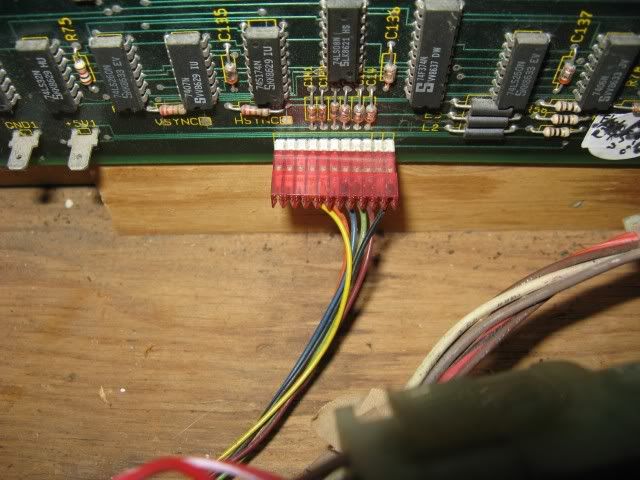

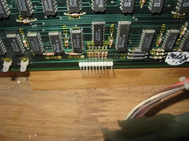

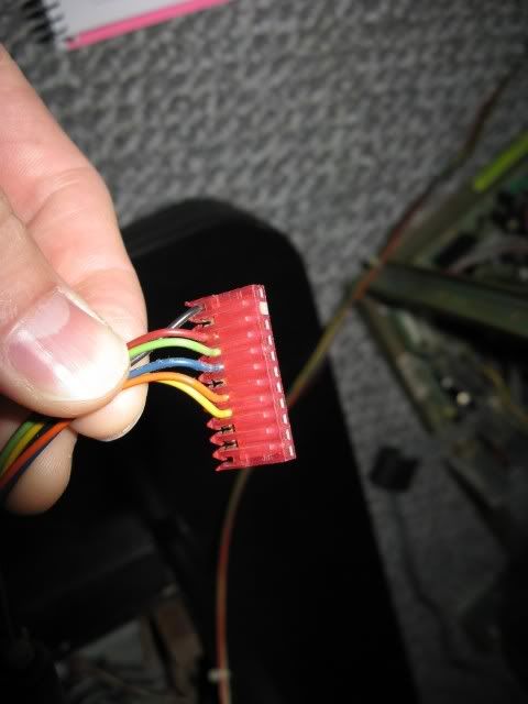

Okay, here are pics from my game:
Chassis end:
Video board end:
Hopefully this will help someone.
Yeah, what he said. It was repaired and recapped by Chad a few years ago. The tube then started pulsating, I replaced the flyback, seemed better for a while, but not great. There's always been a fair amount of burn in it. It's started flickering lately due to some little sparky thing under the fly...probably a bad soldering job or something on my part. in any case, this med res tube has never looked med res, so it's time for an upgrade.
Jedidentist I didn't realize you were the same collector local413 was talking about. So, from your pictures you can see that /Comb sync isn't connected to pin 6 of the connector on the 720 PCB. That is the sync you should use for the 7500 monitor.
